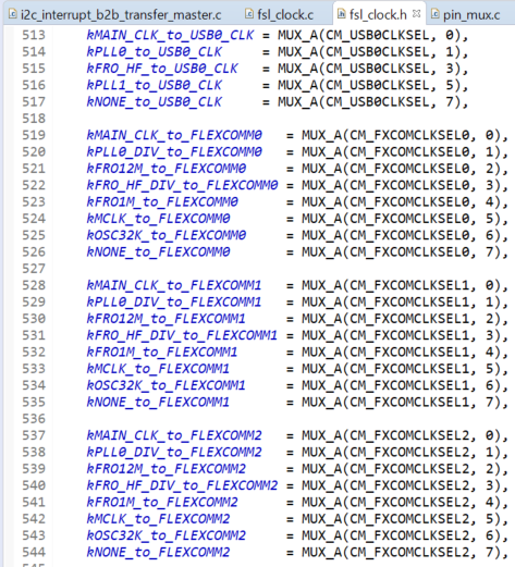

I found out that FLEXCOMM_Init() does not initialize Flexcomm clock source (FCCLKSELx), as described in UM11126, Section 32.4, step 2. I did not find any API function to do that either. SDK version is 2.7.0 (included in Zephyr RTOS as a NXP HAL).
Is that a bug, am I missing something, or should the FCCLKSELx register value be set directly?

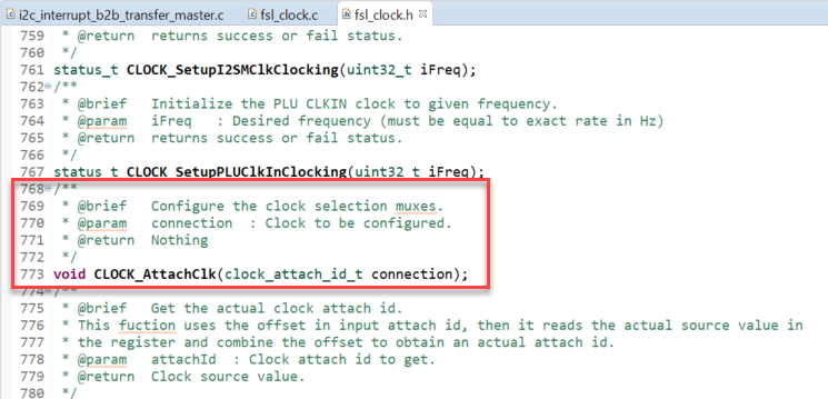

Hope you are doing well. The function you are looking for is this one:
The parameter you need come from this enumeration, you just need to select the correct value: pastedImage_2.png
For example, if you need to select the 12MHz clock to the Flexcomm4, the function is used like this:
Hope this helps. If you have any further question please let me know.
Ricardo

Hi Ricardo,
thanks for clarification! I was searching the code for "FCCLKSEL" and missed that function.
