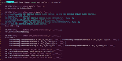

Our board is designed with reference to the iMX8QM-MEK board,GPT1_Capture pin connect to the pwm feedback of fan.
i have try to operate gpt1 from linux arm ,but register (0x5d150000) can'not ioremap .
i can't find other module use it .
When I operate GPT1 from the m4 core0 error occurred.
how can i check which module use GPT1,and how to stop it ?

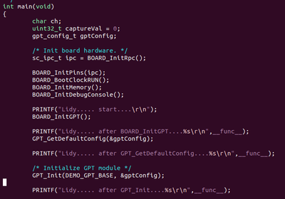

i try to call GPT_Init but failed ,and unable to continue troubleshooting the problem.
code as:
program did't return in CLOCK_EnableClock or GPT_SoftwareReset.
how can i continue find the problem ?

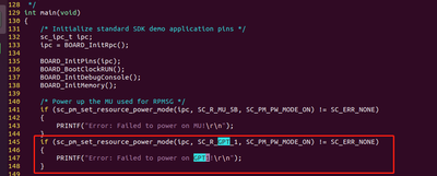

Zhiming_Liu
Hi @lidy
The GPT1_CAPTURE can be pad of i2c2 , LSIO_GPIO0_IO18, LSIO_KPP0_ROW4 and LSIO_GPT1_CAPTURE. You should check these
