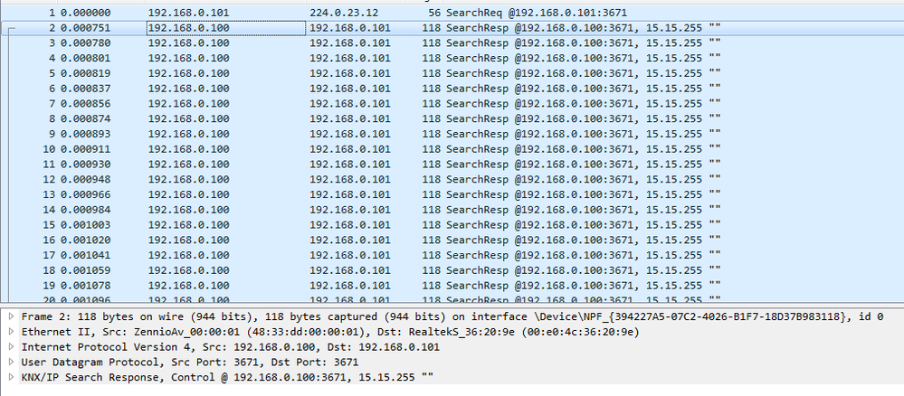

The only testing result we have is a wireshark capturewhere the repeated UDP messages can be seen. I don't know which can be the way to detail the steps to reproduce this issue, as I cannot provide you with our code. As additional information, I have not mentioned that our code using SDK 2.7 and lwIP 2.1.2 works allright if we replace the fsl_enet.c and fsl_enet.h pair of files in SDK 2.7 with the ones from SDK 2.6.

   You also can share the Wireshark test result pictures which demonstrate the bad UDP communication.

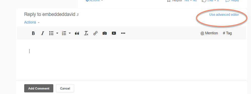

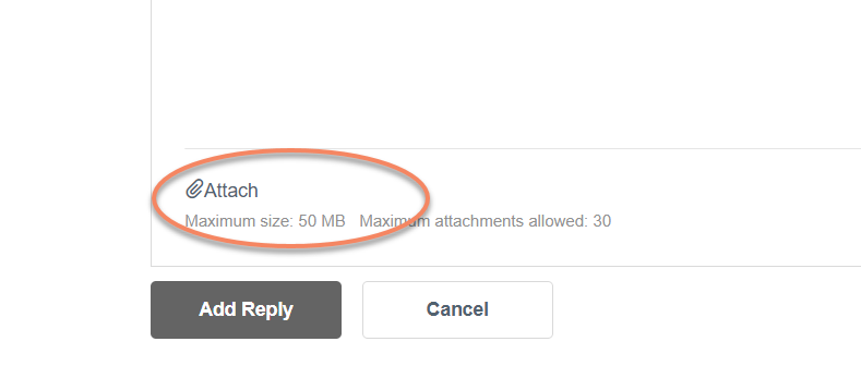

Hi embeddeddavid,
Please use the Attach function, not the insert image, please click the advanced editor.
