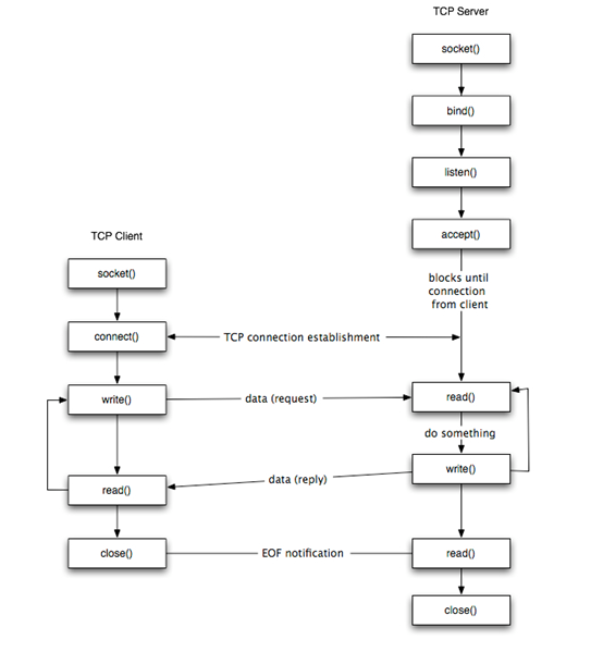

For TCP communications, one host listens for incoming connection requests. When a request arrives, the server accepts it and data is transferred between the server and the client. The sequence of function calls for the client and a server participating in a TCP connection is show in below picture.
The steps for establishing a TCP socket on the client side are the following:
Create a socket using the socket() function.
Connect the socket to the address of the server using the connect() function.
Send and receive data by means fo the recv() and send() functions.
Close the connection by means of the close() function.
The steps in establishing a TCP socket on the server side are as follows
Create a socket with socket() function;
Bind the socket to an address using the bind() function.
Listen for connections with the listen() function.
Accept a connection with the accept() function, this blocks until a client connects.
Send and receive data by means of send() and receive().
