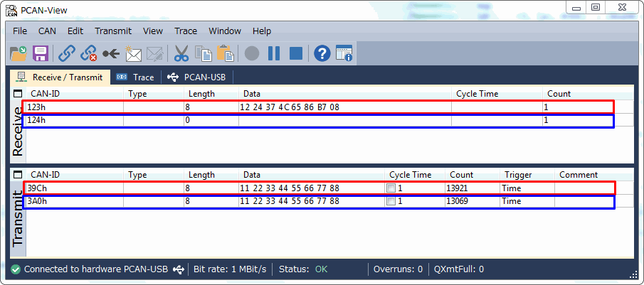

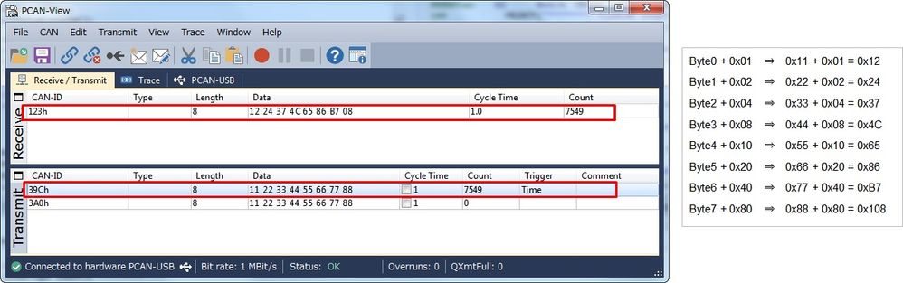

I am working with a TWR-KE18F using a modified sample model. I can send and receive 1 packet of data on the CAN bus, however I am having difficulty reading and sending multiple CAN packet from the bus. I have attached the modified sample model below. Please let me know if you have any suggestions. I would appreciate it if you could tell me the specific operation procedure.

I utilized the following functionyou recommended. However, the modified model stops harfway and does not output CAN normally.
I have attached the modified model below. If possible, please let me know any suggestions.

Dear Kazunori,
I have some recommendations about your code.
If you're using only one CAN bus you should wait until a transfer is made to do the next one, if this is not this way the second transition will be omitted.
Also you should only have one global mask definition, if you have two, you'll only have the second. The mask is an AND logic with the ID so if you put 0x127 in it should do the work.
Also the RX/TX_MESSAGE_BUFFER_NUM should be different for each mailbox, if you don't change it you will overwrite the configurations.
Let me know if this helps you.

I will explain current situation. The model I sent receives 0x39C and sends it at 0x123. This confirmed that it was working properly. I want to add one new data to this model, but it is not successful. (For example, reception 0x3A0, transmission 0x124)
If possible, I would like to receive advice on how to change the model.

Alexis_A
Hi Kazunori,
You have two options for this, you can enable another mailboxes to receive more than one kind of ID. Or also you could enable the FIFO and set the filter to let pass more than one ID. For example, in the SDK for each mailbox the function use to configure it is the next one:
FLEXCAN_SetRxMbConfig(EXAMPLE_CAN, RX_MESSAGE_BUFFER_NUM, &mbConfig, true);
