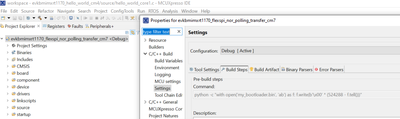

Harry_Zhang
Hi @ywjack
1. Fix the Compiled Size to 512K
You can add a post-build step to pad the binary file. In MCUXpresso IDE, you can specify post-build commands:
1. Open your project properties.
2. Navigate to “C/C++ Build” -> “Settings”.
3. Under “Build Steps”, in the “Post-build steps” section, add a command to pad the binary:
# Replace "my_bootloader.bin" with your actual output binary filename
# Replace "512K" with the fixed size in bytes (524288 bytes)
python -c "with open('my_bootloader.bin', 'ab') as f: f.write(b'\x00' * (524288 - f.tell()))"
This script pads the binary with zeroes up to 512KB.

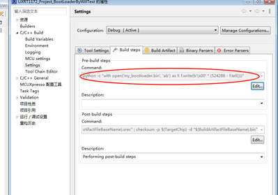

ywjack
Can you show me this screenshot Under "Build Steps", in the "Post-build steps" section, add a command to pad the binary。
According to what you said, 515K is all 0x00, which is not what I want. I need the total bin file size to be 512K, and the unused fill 0x00 or 0xFF

Harry_Zhang
Hi @ywjack
You can refer to below picture.
I didn't say 515K is all 0x00, i said that the total bin file size to be 512K, and the unused fill 0x00 or 0xFF.
Hope this will help you.
Hang

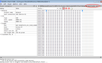

ywjack
I did it according to your configuration, and still generated 512K bin file is 0x00. Is there something wrong with my other configuration? Can you check it for me

Harry_Zhang
Hi @ywjack
You should change my_bootloader.bin name to the generated name.
For example, if your project is evkbmimxrt1170_hello_world_demo_cm7
you should change the my_bootloader.bin to the evkbmimxrt1170_hello_world_demo_cm7.bin
