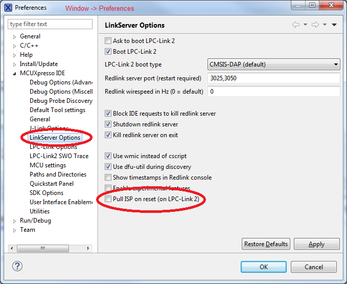

Following this thread:  LPCXpresso, LPC-Link2 and RESET line
I turned off "Pull ISP on reset", under Windows->Preferences_>LinkServer Options:
Even though I do not have the ISP line attached on our target, the LPC-Link2 still uses the RESET line if that mode is enabled.
And I set "Attach Only" to "False" under the Project's debugger configuration, which allows scripts to run:
I no longer see the RESET signal being asserted low upon initiating a debugger session. That was causing the Reset Supervisor IC to stretch the reset longer than the debugger's wait time.
Note that it doesn't need the reset delay script you suggested.  It wouldn't help anyhow because the debug mode looks for the CPU cores before it runs the script.

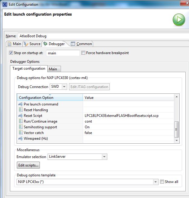

The LPC-Link2 firmware has a couple of proprietary additions, so it's not open source. And, you don't need it. I'd recommend you add a custom reset script with a built in delay. LinkServer includes an example script which can be used to program a delay. See the delayexample.scp in the Scripts folder.
When a reset script is used, MCUXpresso presumes everything reset related is included in the script. So, for example, you'll need to add a command to send a core reset signal to the part. I've cut and paste a script below should do what you need. Note you'll edit your project debug configuration to use a reset script.

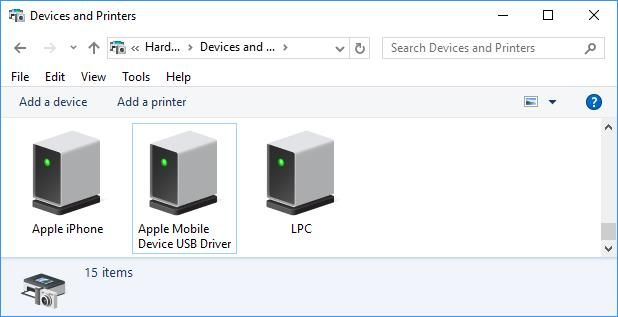

Here's what I get when I boot with jumper 1 removed (DFU mode):
I ran MCUXpresso and went to the "chip" icon to erase flash:
It sees the device and could erase the external SPIFI flash in our target. Good so far.

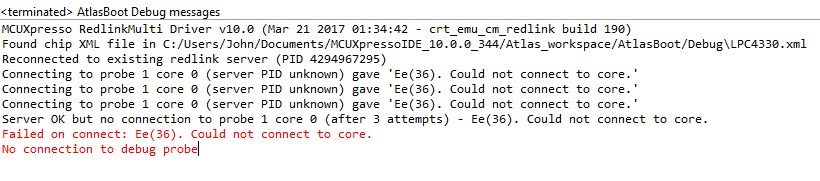

But, when I try to run a debugger session, I get this:
I tried with and without JP2 installed (buffer power). Same error.
My debug config for the project looks like this:

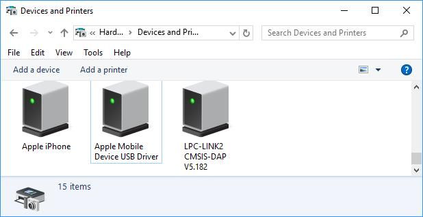

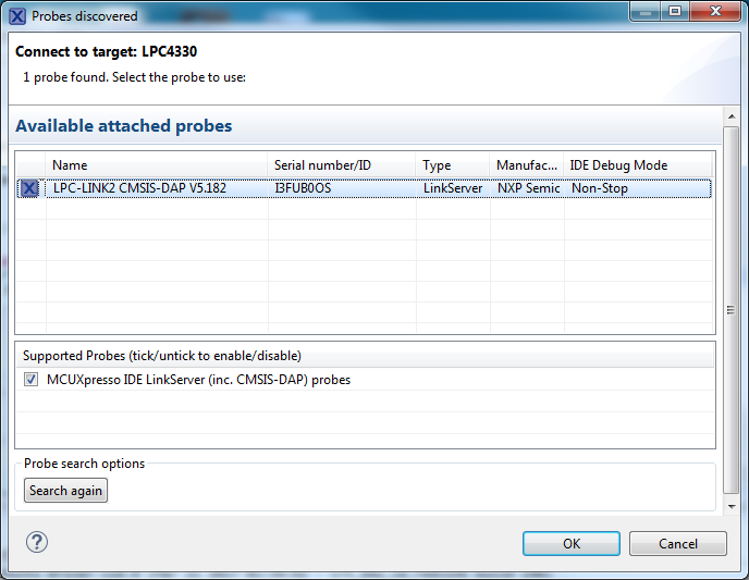

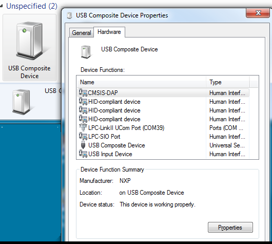

So, I used LPCScrypt and flashed it with CMSIS-DAP. Installed jumper 1 and power cycled the LPC-Link2.
It showed up like this in Devices and Printers:
A slightly older version that the one MCUXpresso loads (5.182).
I repeated the session with the same error when trying to start the debugger.

lpcxpresso_supp
John,
Based on the information above, the IDE has good communications with the debug probe (despite the slightly miss-leading error), the problem is that the LPC-Link2 cannot communicate with the target MCU. (You would see exactly this behaviour if there was no 10 way debug connection to the board).
Therefore initially I would focus on the physical connection from the LPC-Link2 to your target.
1 - check the basics, is the 10 wire debug cable connected to J7 on the LPC-Link2 board
2 - is the wire orientation correct onto your custom LPC4330 hardware
3 - check the target is powered either locally or via the LPC-Link2 (JP2 link made)
