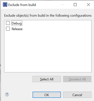

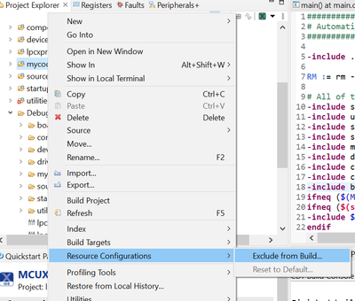

When we create a new folder in a project, make sure the folder and files are included in the project.
go to "Exclude from Build",
unckeck "debug" and "release"
the folder will be included in mk files after build.
Accordingly, checking "Debug" and "Release" excludes the folder from the project and remove the path from mk file.
