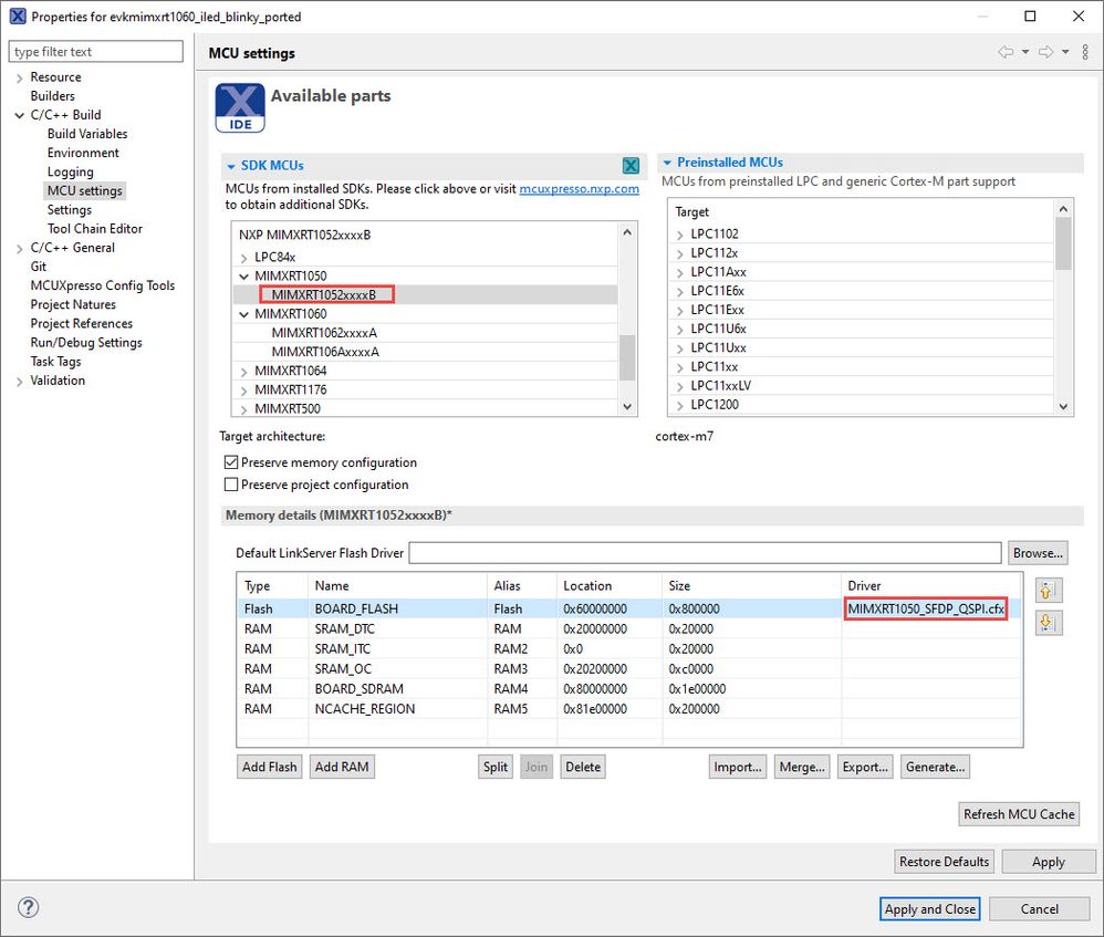

Following the "MCUXpresso IDE User Guide" section "Changing the MCU (and associated SDK)", changed the MCU to MIMXRT1052xxxxB.  Also changed the flash driver to MIMXRT1050_SFDP_QSPI.cfx.  If using Segger JLink, see https://wiki.segger.com/i.MXRT1050 to change the flash algorithm to QSPI.

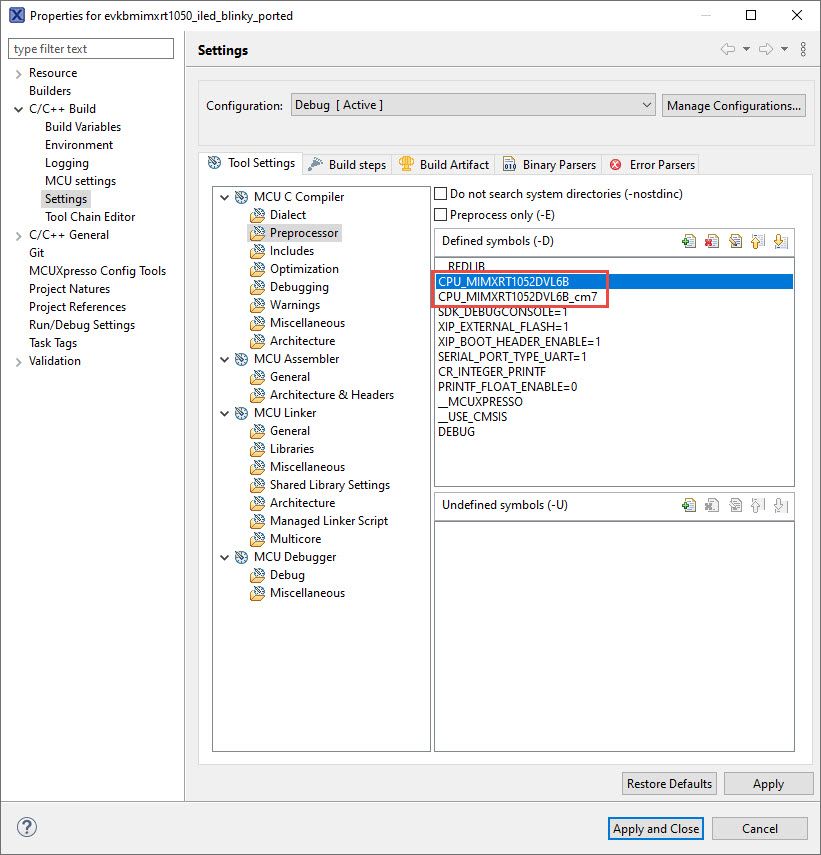

And then changed the package/part number to MIMXRT1052DVL6B.
Changed the project name to evkbmimxrt1050_iled_blinky_ported
Changed the C Compiler Preprocessor definitions to the SDK device CPU_MIMXRT1052DVL6B

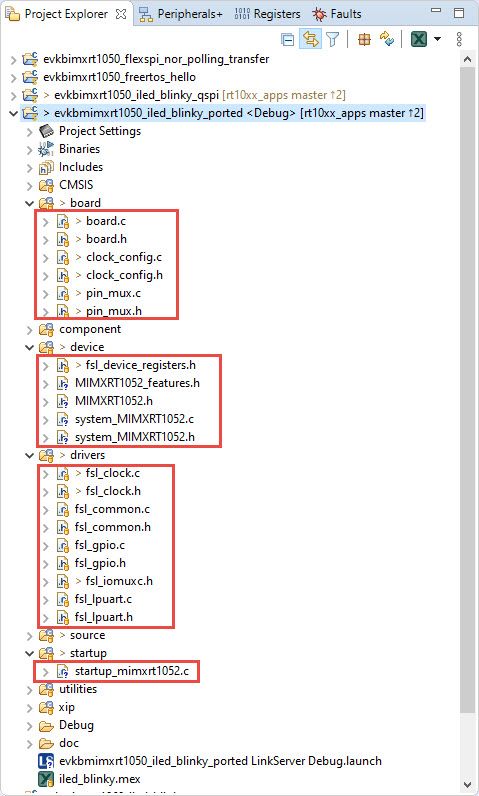

Replaced the files from the SDK package EVKB-IMXRT1050_SDK_2.8.2 (Note: MCUXpresso IDE supports "SDK Project Component Management", which could also be used for updating some of these files.  See section "SDK Project Component Management" of the IDE user guide.  But I replaced the files manually myself from the RT1050 SDK package):
  • device folder with the SDK files from EVKB-IMXRT1050_SDK_2.8.2.zip\devices\MIMXRT1052.
  • startup file from \EVKB-IMXRT1050_SDK_2.8.2.zip\devices\MIMXRT1052\mcuxpresso\
  • drivers files from \EVKB-IMXRT1050_SDK_2.8.2.zip\devices\MIMXRT1052\drivers\
  • board files, can use an SDK example for the ported device, or generate the clock_config and pin_mux files from the MCUXpresso Config tools
  • xip files would also need to be updated if flash configuration changes.  In this example, both boards are using the same QSPI flash, and these files are the same.
Delete the .launch debug configuration file in the project.  MCUXpresso IDE will regenerate it.
With these changes, the ported project runs on the RT1050 EVK.
