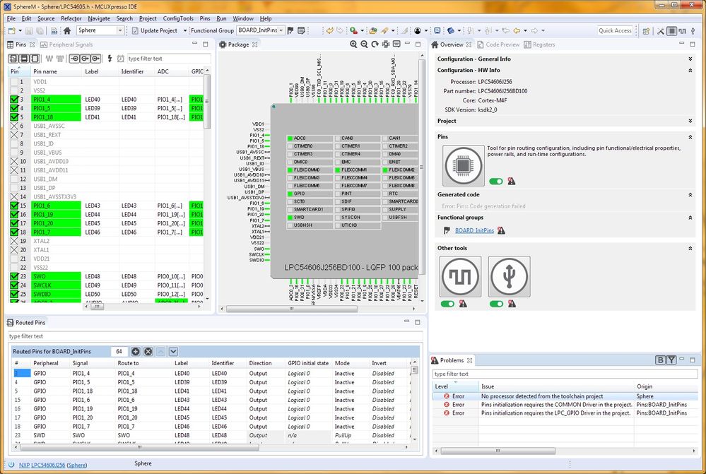

MCUXpresso Config Tools screenshot.jpgWhen "updating project" from the ConfigTools withing MCUXpresso IDE, I get the following 3 errors in the "Problems" window:
Level: Error
Type: Tool problem
Tool: McuConfiguration
Issue: No processor detected from the toolchain project
Origin: Sphere
Resource: Project
Level: Error
Type: Validation
Tool: Toolchain/IDE project
Issue: Pins initialization requires the COMMON Driver in the project.
Origin: Pins:BOARD_InitPins
Target: Toolchain/IDE project: core0
Resource: platform.drivers.common
Level: Error
Type: Validation
Issue: Pins initialization requires the LPC_GPIO Driver in the project.
Resource: platform.drivers.lpc_gpio
First error may be due to the fact that while my MCUXpresso project is for a LPC54605C256BD100 I have to select LPC54606J256BD100 in the ConfigTools since the SDK 2.4.1 does not contain the LPC54605C256BD100.
As for the next 2 errors, where do I find the missing drivers mentioned? I have already imported the "drivers" (with fsl_xxx.c and .h files) and "CMSIS" folders from the SDK examples, but this seems to be somewhere else.

first thing you can try is to use the latest version of IDE/Config Tools (released a week ago) + the latest SDK (regenerate the SDK package on the mcuxpresso.nxp.com). If it does not help, please share the project and/or specify exact steps what did you select in the new configuration wizard (empty project, or cloned example), and what other changes you did.
Thank you,
Libor

You can use the SDK for LPC54605J256ET180, use a larger package is not crucial for SDK.
In addition, it is planning an SDK release for LPC54605 pin100 next year.
