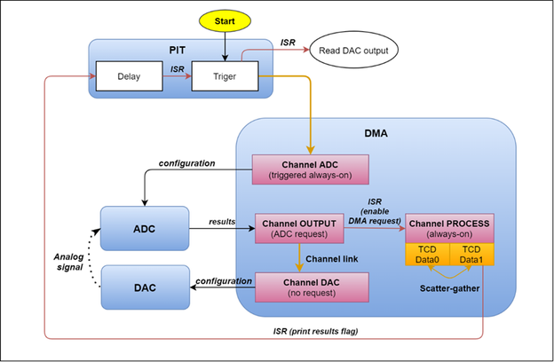

The main goal of this application is to show the configuration of the DMA peripheral which can be used for the ADC channel to be measured and for collecting the results into the resulting output array. It demonstrates an approach for periodic measurement of multiple ADC channels without CPU intervention. It can be used on any MCU with a simple ADC peripheral (without a possibility to queue measured channels).
3.2. Application details
The application starts with the initialization of pins, clocks, and peripherals configured by the MCUXpresso Config Tool. After the initial state is printed to the console, it starts the PIT (periodic interrupt timer). The PIT channel named Trigger causes periodic transfer on the DMA channel named ADC, which configures the ADC peripheral’s channel to be measured. When the timer counting is completed, the ADC measures the analog signal of the DAC peripheral that has been already initialized. The interrupt routine of the PIT Trigger channel includes the actual DAC data reading sequence that will be printed at the end of the console.
After the end of the measurement loop, there is the ADC peripheral’s DMA request which initiates the DMA channel named OUTPUT to read the measured ADC data. The DMA channel OUTPUT links the DMA channel named DAC, which increases the buffer read index of the DAC peripheral and generates the next analog signal to be measured by the ADC. The sample number corresponds to the number of major loops of the DMA channel OUTPUT. The major count completion interrupt of the DMA channel OUTPUT stops the measurement trigger (PIT) and enables the DMA request of the DMA channel named PROCESS. The DMA channel PROCESS processes the whole dataset by sorting it into individual data buffers using the scatter-gather function. The major count completion interrupt of the DMA channel PROCESS sets the flag for printing the results and starts the delay timer (PIT second channel named Delay) that delays individual measurements. The post-delay interrupt routine stops the PIT Delay channel and restarts the PIT Trigger channel, which initiates the whole cycle again.
Figure 1. Application diagram

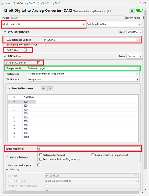

4.1. DAC peripheral
The DAC peripheral is used for creating simulated data to be measured by the ADC.
DAC peripheral setup:
  • ModeBuffered
  • DAC reference voltage – DACREF_2 – the same voltage reference as for ADC, so that both peripherals are in the same voltage ranges.
  • Enable DACtrue
  • Enable DAC buffer - true
  • Trigger modeSoftware trigger (configured by DMA write to register C0, corresponds to the dac_trigger[] configuration)
  • Work modeSwing mode (demonstration choice)
  • Data buffer values – 10 demonstrations of values from 100 to 1000 with step 100
  • Buffer read index - 0
The DAC buffer works in swing mode, so it moves the buffer read index from the first item to the last, then back to the first, and so on. After the one loop is measured by the ADC nearly the same values are printed out to the console log, due to the same voltage reference selected in both the DAC and the ADC. The DAC interrupt is not used.
Figure 2. DAC Configuration

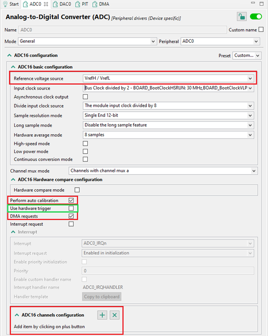

4.2. ADC peripheral
The ADC peripheral is used for measuring an analog signal (in this case, generated by the DAC peripheral) and converting it into a digital signal.
ADC peripheral setup:
  • Reference voltage sourceVrefH/VrefL
  • Input clock source – Bus clock divided by 2.
  • Asynchronous clock outputfalse
  • Divide input clock source by 8 (to achieve better accuracy)
  • Sample resolution mode – Single-end 12-bit (the same as DAC resolution)
  • Perform auto-calibrationtrue (to achieve better accuracy)
  • Use hardware trigger – false
  • DMA requeststrue
The ADC channel selection is configured by the DMA. The adc_trigger[] array includes configurations of the SC1A register, which selects and triggers the ADC channel measurement.
The clock frequency for the ADC measurement is set to 3.75 MHz. The conversion time is calculated in the following way:
Conversion time = SFC adder + AverageNum * (BCT + LST adder + HSC adder)
Where:
  • SFC adder (Single or First Continuous time adder): 5 ADCK + 5 bus clock cycles
  • AverageNum (Average Number factor): 8
  • BCT (Base Conversion Time: for 12-bit single-ended): 20 ADCK
  • LST adder (Long Sample Time adder): 0 ADCK
  • HSC adder (High-Speed Conversion time adder): 0 ADCK
  • ADCK (ADC clock cycle period): (16/60000000) s
The resulting conversion time is calculated as follows:
 Conversion time = (5 ADCK + 5 bus clock cycles) + 8 * (20 ADCK + 0 ADCK + 0 ADCK)
= 165 * 16/60000000 + 5/60000000
= 44.083 us
Figure 3. ADC configuration

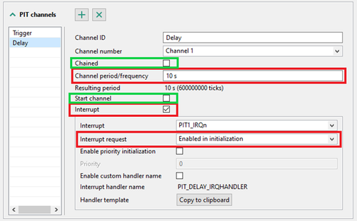

PIT Channel 1 is configured to set a delay for printing results. It starts at the end of the measurement loop.
PIT channel 1 setup:
  • Channel IDDelay (optional identifier)
  • Channel number1
  • Channel period10 s (period of the whole measurement loop)
  • Interrupttrue
  • Interrupt requestEnabled in the initialization

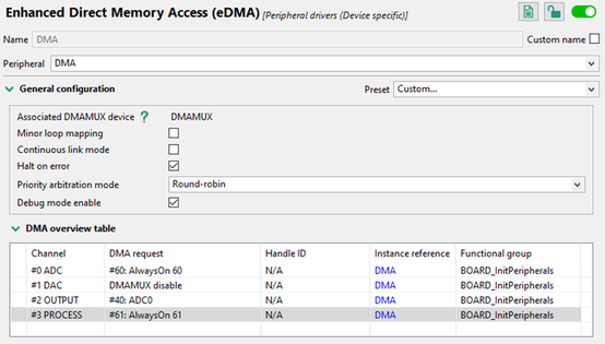

4.4. eDMA peripheral
The eDMA peripheral component initializes the DMA and DMAMUX (DMA request multiplexer) peripherals. The DMA controller enables moving data from one memory-mapped location to another without CPU involvement.
Note: The error interrupt vector and channel error event for all DMA channels are enabled. It can improve the debugging process. The ISR is defined in the DMA_ERROR handler.
eDMA peripheral setup:
  • Priority arbitration mode – Round-robin (no specific channel priorities were set because channels are not used simultaneously)
  • Debug mode enabletrue (application is demonstrated in debug mode)
Figure 6. General eDMA configuration overview

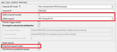

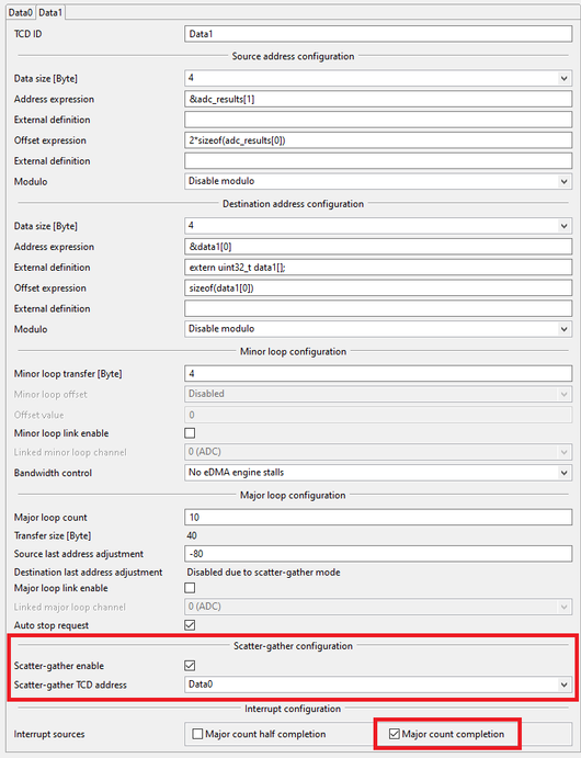

The application example uses 4 DMA channels for control:
  • ADC (always-on DMA request triggered by PIT)
  • DAC (disabled DMA request)
  • OUTPUT (ADC peripheral DMA request)
  • PROCESS (always-on DMA request)
All used DMA channels are configured as Non-transactional (TCD structures) channel API mode, which allows you to configure all TCD (Transfer Control Descriptor) registers.

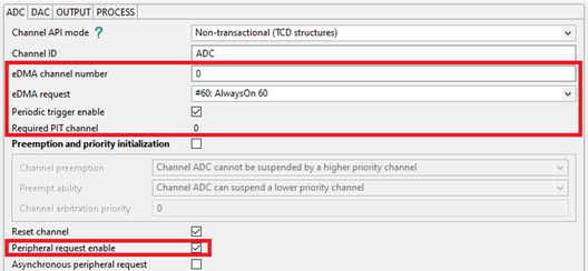

4.4.1. Channel ADC
The eDMA channel ADC (Figure 7) is used for setting and triggering the ADC channel to measure the analog signal generated by the DAC peripheral. It demonstrates the use-case of a triggered always-on DMA request when the selected DMA channel (0) is triggered by the corresponding PIT channel (0). The peripheral request is enabled; therefore, the channel operates immediately after the PIT trigger timer starts and completes counting.
eDMA channel ADC setup:
  • Channel API mode - Non-transactional (TCD structures)
  • Channel ID ADC (optional channel prefix name)
  • eDMA channel number 0
  • eDMA request AlwaysOn (any always-on request number)
  • Periodic trigger enable true (requires initialization of PIT channel 0)
  • Reset channel true
  • Peripheral request enabletrue
Figure 7. DMA channel ADC configuration

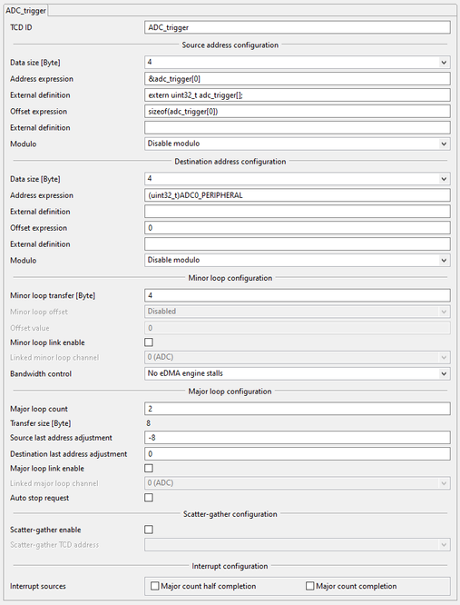

The Transfer Control Descriptor for the DMA channel ADC (Figure is configured as memory-to-peripheral transfer, which configures the ADC peripheral for measurement.
eDMA channel ADC TCD named ADC_trigger setup:
  • TCD IDADC_trigger
Source address configuration
  • Data size [Byte]4 (one minor loop transfers 4 bytes, which corresponds with the destination register size)
  • Address expression&adc_trigger[0] (contains 2 configurations of the ADC0::SC1A register, for demonstration purposes both selected the same ADC channel 23 (0x17) interconnected with the DAC output. The configurations can be different)
  • External definition – extern uint32_t adc_trigger[];
  • Offset expression – sizeof(adc_trigger[0]) (SOFF = 4 bytes)
  • ModuloDisable modulo
Destination address configuration
  • Data size [Byte]4 (one minor loop transfers 4 bytes, which corresponds to the destination register size)
  • Address expression((uint32_t)(&ADC0_PERIPHERAL->SC1[0])) or (uint32_t)ADC0_PERIPHERAL (it is the first register of the peripheral ADC)
  • Offset expression0 (DOFF = 0 bytes, destination address is always the same – ADC0::SC1A)
Minor loop configuration
  • Minor loop transfer [Byte] – 4
  • Minor loop offset – Disabled
  • Minor loop link enable false
  • Bandwidth control No eDMA engine stalls
Major loop configuration
  • Major loop count 2 (MAJOR_LOOP_COUNT – 2 ADC configurations)
  • Source last address adjustment – -8 (SLAST = (-1) * SOFF * MAJOR_LOOP_COUNT)
  • Destination last address adjustment – 0 (DLAST = (-1) * DOFF * MAJOR_LOOP_COUNT)
  • Major loop link enable false
  • Auto stop request false (channel operation is triggered by the hardware – PIT trigger)
Scatter-gather configuration
  • Scatter-gather enablefalse
  • Constant TCDs - true
  • Initialize TCD - ADC_trigger
Figure 8. DMA channel ADC TCD configuration

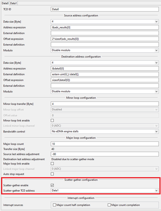

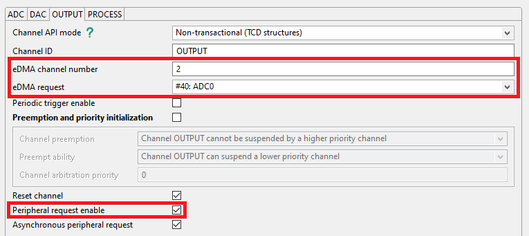

4.4.3. Channel OUTPUT
The DMA channel OUTPUT (Figure 11) is used for reading the ADC peripheral results and storing them in memory. It demonstrates the DMA channel (2) configuration using the DMA peripheral request (ADC). The peripheral request is enabled; therefore, the channel operates immediately after the ADC measurement is done.
eDMA channel OUTPUT setup:
  • Channel ID OUTPUT (optional channel prefix name)
  • eDMA channel 2
  • eDMA request ADC0
  • Enable periodic trigger false
  • Enable channel reset - true
  • Enable peripheral requesttrue
  • Asynchronous peripheral requesttrue
Figure 11. DMA channel OUTPUT configuration

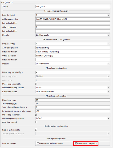

The TCD for the DMA channel OUTPUT (Figure 12) is configured as a peripheral-to-memory transfer which reads the measured values by the ADC peripheral.
eDMA channel OUTPUT TCD named ADC_RESULTS setup:
  • TCD IDADC_RESULTS
  • Data size [Byte]4 (one minor loop transfers 4 bytes which corresponds to the destination register size)
  • Address expression(uint32_t)(&ADC0_PERIPHERAL->R[0]) (reads results from ADC0::RA register)
  • Offset expression – 0 (SOFF = 0 bytes, the source address is always the same)
  • Data size [Byte]4 (one minor loop transfers 1 byte which corresponds to the destination register size)
  • Address expression&adc_results[0]
  • External definition extern uint32_t adc_results[];
  • Offset expressionsizeof(adc_results[0]) (DOFF = 4 bytes)
  • Minor loop link enable true
  • Linked minor loop channel 1(DAC) (every minor loop eDMA channel DAC is linked which triggers the DAC and increases the buffer index that changes the DAC output value)
  • Major loop count 20 (MAJOR_LOOP_COUNT – 20 measured samples)
  • Source last address adjustment – -0 (SLAST = (-1) * SOFF * MAJOR_LOOP_COUNT)
  • Destination last address adjustment - -80 (DLAST = (-1) * DOFF * MAJOR_LOOP_COUNT)
  • Major loop link enable true
  • Linked major loop channel 1(DAC) (last minor loop increases the DAC buffer index for the next measurement cycle)
  • Enable scatter-gatherfalse
Interrupt configuration
  • Interrupt sources Major count completion (After the measurement cycle, the interrupt DMA_OUTPUT is invoked. The ISR clears the status flags of the DMA channel OUTPUT channel, stops the PIT trigger timer, and enables the peripheral request of the DMA channel PROCESS. This way, it initiates the next operation.)
  • Initialize TCD – ADC_RESULTS
  • - Enable channel interrupt true
  • - Interrupt request Enabled in initialization
  • - Enable custom handler name - true
  • - Interrupt handler name DMA_OUTPUT
Figure 12. DMA channel OUTPUT TCD configuration
4.4.4. Channel PROCESS
The DMA channel PROCESS (Figure 13) is used for processing the results and storing them in memory. It demonstrates the DMA channel (3) configuration using a DMA always-on request. The peripheral request is disabled; therefore, the channel operates after the request is enabled by the software. In the example application, the DMA request is enabled in the interrupt routine of the DMA channel OUTPUT which is invoked after all major loops transfers are completed (measurement finished). After this DMA transfer, there are two arrays of results, one for each ADC configuration, see configuration array adc_trigger[].
eDMA channel PROCESS setup:
  • Channel ID PROCESS (optional channel prefix name)
  • eDMA channel 3
  • Periodic trigger enable false
  • Reset channeltrue
  • Peripheral request enablefalse
Figure 13. DMA channel PROCESS configuration
The DMA channel PROCESS contains pre-configured TCDs as memory-to-memory transfers that process the measured data using scatter-gather functionality. In the example application, the data from one source data-array adc_results[] is scattered into two destination data-arrays, data0[], and data1[]. The DMA channel ADC contains two ADC configurations to be measured. The values measured by the first ADC channel configuration are stored into the data0, and after that, the second ADC channel configuration data into the data1.
eDMA channel TCD Data0 setup:
  • TCD IDData0
  • Data size [Byte]4 (sample size)
  • Address expression&adc_results[0] (first sample)
  • Offset expression – 2*sizeof(adc_results[0]) (SOFF = 8 bytes, read every second sample)
  • Data size [Byte]4
  • Address expression&data0[0]
  • External definition extern uint32_t data0[];
  • Offset expressionsizeof(data0[0]) (DOFF = 4 bytes)
  • Major loop counts 10 (MAJOR_LOOP_COUNT – 10 samples)
  • Source last address adjustment – -80 (SLAST = (-1) * SOFF * MAJOR_LOOP_COUNT)
  • Destination last address adjustment – Disabled due to scatter-gather mode
  • Auto stop request false (always-on request still enabled)
  • Enable scatter-gathertrue
  • Scatter-gather TCD addressData1
Setup eDMA channel TCD Data1:
  • TCD IDData1
  • Address expression&adc_results[1] (second sample)
  • Data size [Byte]4
  • Address expression&data1[0]
  • External definition extern uint32_t data1[];
  • Offset expressionsizeof(data1[0]) (DOFF = 4 bytes)
  • Auto stop request true  (stops always-on request)
Scatter-gather TCD addressData0
  • Interrupt sources Major count completion (After the last major loop of the TCD Data1, the interrupt DMA_PROCESS is invoked. The ISR clears the status flags of the DMA channel PROCESS channel, sets the print flag, and starts the PIT delay timer. The results are printed in the console.)
  • Initialize TCD – Data0
  • Enable channel interrupt true
  • - Interrupt handler name DMA_DATA_PROCESSED
Figure 14. DMA channel PROCESS TCD configuration Data0
Figure 15. DMA channel PROCESS TCD configuration Data1
5. Application design
Global variables and definitions:
Definitions:
•	SAMPLE_COUNT - number of the measured values from one measurement loop – one swing through DAC buffer (10 values) to top and back => 2 * 10
•	DATA_COUNT - number of the data in each separated output array
•	ADC_CONFIGURATIONS - number of values (channel settings) for ADC0_SC1A register
•	DAC_TRIGGER_CONFIGURATIONS - number of values (SW trigger) for DAC0_C0 register
Main global variables:
•	dac_output - Result buffer with DAC output, the array of DAC values filled from the actual pointed buffer index – used for printing purposes/* Result buffer with ADC measurement output - interleaved channels measured data, one by one */
AT_NONCACHEABLE_SECTION_INIT(uint32_t adc_results[SAMPLE_COUNT]) = {0};
/* Process data buffers – output separated measured data from the two selected ADC channels into these two arrays */
AT_NONCACHEABLE_SECTION_INIT(uint32_t data0[DATA_COUNT]) = {0};
AT_NONCACHEABLE_SECTION_INIT(uint32_t data1[DATA_COUNT]) = {0};
/* ADC channel selection: twice channel 23 configuration – 0x17; here you can specify your own channels numbers when you transform the tutorial to real application */
AT_NONCACHEABLE_SECTION_INIT(uint32_t adc_trigger[ADC_CONFIGURATIONS]) = {0x17, 0x17};
/* Set DAC software trigger configuration – 0xF0 */
AT_NONCACHEABLE_SECTION_INIT(uint8_t dac_trigger[DAC_TRIGGER_CONFIGURATIONS]) = {0xF0};
Functions and interrupt handler's description:
int main(void) {
/* Initialization of MCU (pins, clocks and peripherals) */
/* Start the DMA trigger */
    PIT_StartTimer(PIT_PERIPHERAL, PIT_TRIGGER);
/* Inside infinite loop */
if(printFlag){
        	printBuffers();
/* PIT0_IRQn interrupt handler */
void PIT_TRIGGER_IRQHANDLER(void) {
/* After each ADC trigger */
/* Fill dac_output array by the actual value */
/* PIT1_IRQn interrupt handler */
void PIT_DELAY_IRQHANDLER(void) {
/* At the end of the measurement loop after printing out */
/* Stop delay timer */
  PIT_StopTimer(PIT_PERIPHERAL, PIT_DELAY);
/* Start triggering in the next measurement loop */
/* DMA2_DMA18_IRQn interrupt handler */
void DMA_OUTPUT(void) {
  /* After all measurement results in actual loop is transferred by DMA to  adc_results[] */
  /* Stop DMA trigger */
  PIT_StopTimer(PIT_PERIPHERAL, PIT_TRIGGER);
  /* Enable data process DMA channel request */
  EDMA_EnableChannelRequest(DMA_DMA_BASEADDR, DMA_PROCESS_DMA_CHANNEL);
/* DMA3_DMA19_IRQn interrupt handler */
void DMA_DATA_PROCESSED(void) {
/* After finishing separation DMA transfers from adc_results[] to the data0[] and data1[] */
/* Start delay next measurement and results printing */
  PIT_StartTimer(PIT_PERIPHERAL, PIT_DELAY);
/* DMA_Error_IRQn interrupt handler */
void DMA_ERROR(void) {
/* Just for sure */
void printBuffers() {
/* Printed out the DAC values with ADC measured values for comparison */
