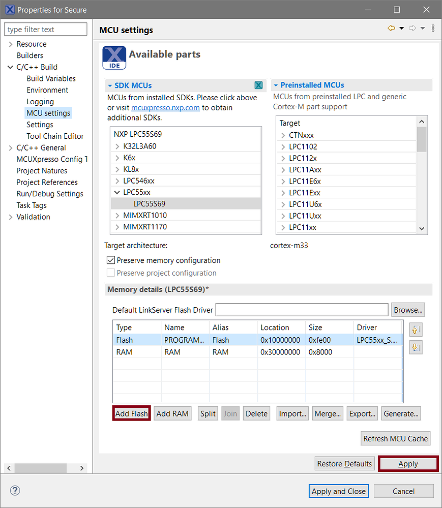

  1. Reserve some flash memory space for SG_veneer_table first. Navigate to Project > Properties > C/C ++ Build.
  2. Locate the MCU settings in SDK MCUs.
  3. Click Add Flash and add SG_veneer_table at 0x1000fe00, size 0x200 bytes.
  4. Click Apply.

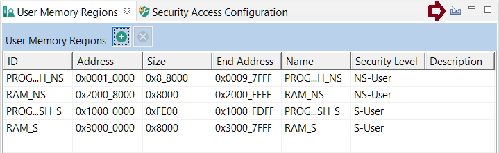

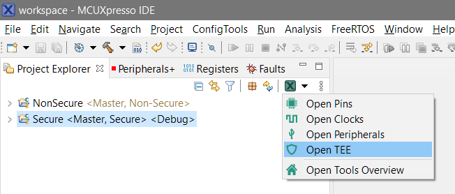

  1. Now setup the newly added flash memory region as NSC in the TEE tool. To switch to the TEE tool, click the Open MCUXpresso Configuration button in the Project Explorer, and select Open TEE.

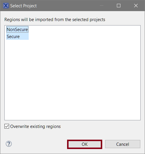

  1. The TEE tool is capable of importing project-wide memory regions from multiple projects at once. To import memory regions, click the Import button in the User Memory Regions view.
  1. In the Select Project dialog, select both NonSecure and Secure projects and click OK.

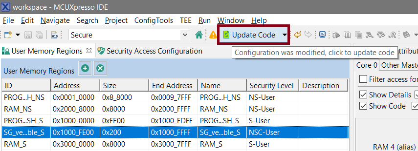

  1. Quick-fix the reported error Issue: SAU+IDAU: The following security requirements are not satisfied: NS_CALLABLE by right-clicking the cell and selecting the quick-fix from the context menu.
  1. To save the changes, click Update Code.

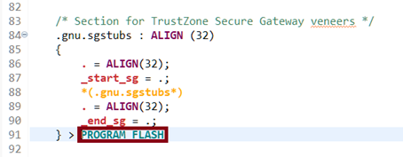

  1. MCUXpresso IDE v11.3.0 and earlier versions contain a bug that messes up linker script and puts SG veneers into PROGRAM_FLASH instead of SG_veneer_table when you’re modifying an existing project.

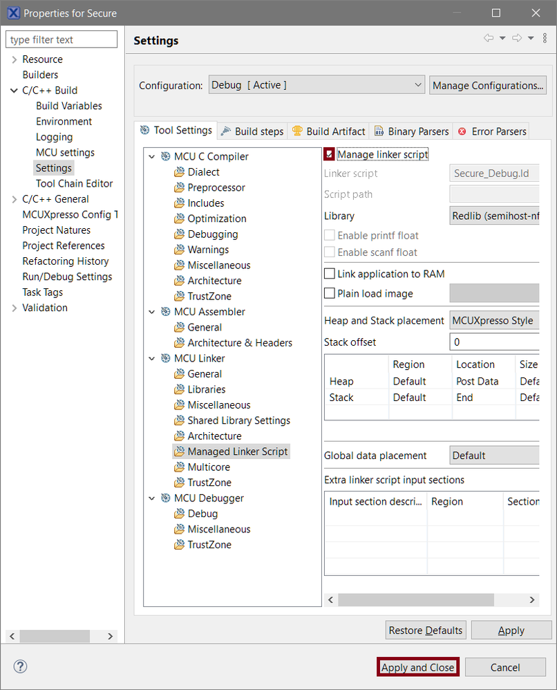

  2. To work around the problem, navigate To Project > Properties > C/C ++ Build > Settings > MCU Linker > Managed Linker Script.
  3. Deselect the Manage linker script checkbox and click Apply and Close.
  1. Edit the script manually by opening the Debug/Secure_Debug.ld inside the IDE, find the .gnu.sgstubs section and direct it to SG_veneer_table instead of PROGRAM_FLASH.

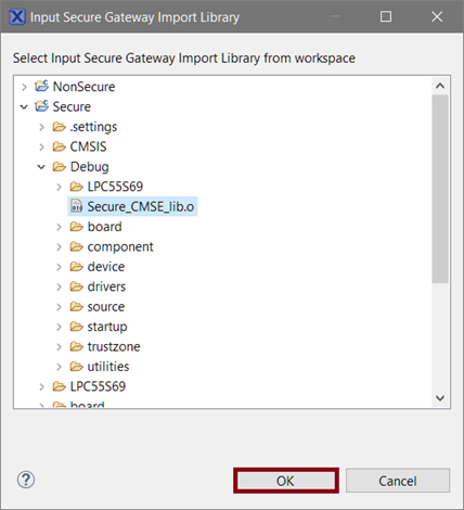

If you attempt to build the S project now, you’ll receive several linker errors telling you the NSC library could not be built as there are no NSC functions (yet) including the name of the said library: Secure_CMSE_lib.o. You’re going to use it to configure the Non-Secure project named “Non-Secure”.

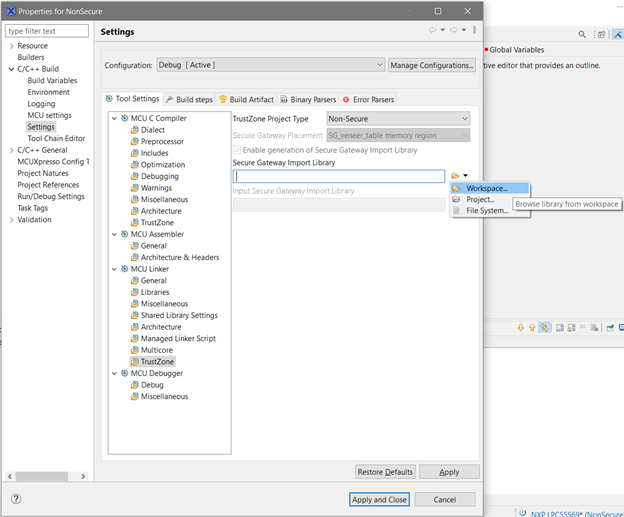

  1. Navigate to Project > Properties > C/C ++ Build > Settings > MCU Linker > TrustZone.
  2. Click the Import button next to the Secure Gateway Import Library field, and select Workspace.
  1. In the Input Secure Gateway Import Library dialog, select Secure_CMSE_lib.o and click OK.
You will see “${workspace_loc:/Secure/Debug/Secure_CMSE_lib.o}” in the Secure Gateway Import Library field of the MCU Linker Setting dialog.

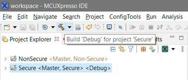

  1. To rebuild the Secure project and generate the NSC import library click the Build ‘Debug’ for project ‘Secure’ button in the Toolbar.
