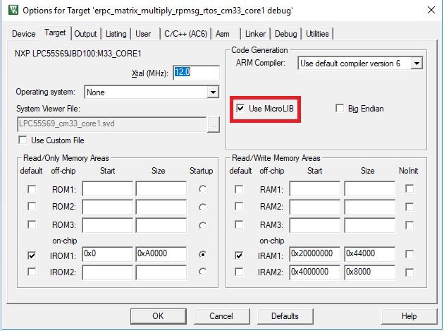

We set Use MicroLIB in Keil as below by default or use ld flags "--library_type=microlib" in yaml:
If you do not want this option to be set, "--library_type=standardlib"  or  "--library_type=nomicrolib"
could be set in ld flags.
