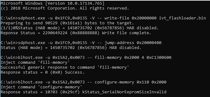

I'm trying to flash a external memory using the LPSPI module and the flashloader. According to the Flashloader manual the LPSPI module can be used for Serial NOR/EEPROM memories but I had not been lucky.
  1. I flash the Flashloader into RAM using SDPHOST utility.
  2. Using BLHOST utility:
    1. blhost -u -- fill-memory 0x2000 0x04 0xc0333007 (write option block to SRAM address 0x2000)
    2. blhost -u -- configure-memory 0x110 0x2000
  3. Then I try to read the memory using BLHOST:
    1. blhost -u -- read-memory 0x60000000 0x200
  4. I get the error 10205 (0x27dd) kStatusMemoryNotConfigured
My setup:
MCU: RT1064
External memory: IS25WP128/064/032
Peripheral: USB
Please advice.

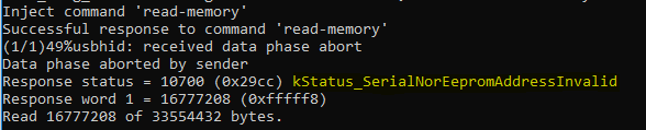

julio_delgado
Hello Kerry and Jay,
Thank you for the support on this.
I used the new Flashloader and I no longer get an error message when the memory is configured, but when I try to write or read any address after 16MB I get the same error:
Writing:
C:\Users\..\bin\Debug>blhost.exe -u 0x15A2,0x0073  -- write-memory 0x00000000 nvm.bin 0x110
Inject command 'write-memory'
Preparing to send 33554432 (0x2000000) bytes to the target.
Successful generic response to command 'write-memory'
(1/1)100% Completed!                  <-- The % was increased at regular speed before 50%, after, it increased faster.
usbhid: received data phase abort
Response status = 10200 (0x27d8) kStatusMemoryRangeInvalid  <-- Same error than before
Wrote 33554432 of 33554432 bytes.
Reading:
C:\Users\..\bin\Debug>blhost.exe -u 0x15A2,0x0073  -- read-memory 0x1000000 0x100 0x110
Inject command 'read-memory'
Successful response to command 'read-memory'
Data phase aborted by sender
Response word 1 = 0 (0x0)
Read 0 of 256 bytes.

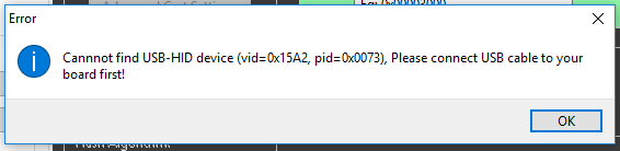

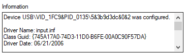

julio_delgado
Hello Kerry,
Thank you again for the fast support. I used the new Flashloader (Both) and I get this error:
If I see the USB properties on the Device Manager I observe that the Device did not change to the Flashlaoder's VID and PID:
Can you please help me to investigate this?
Thank you

jay_heng
This is a limitation in Flashloader, as Flashloader is designed to support EEPROM (default recovery device), so 16MB is large enough for EEPROM. this limitation applies to 1-bit NOR as well. If customer do want to program 32MB NOR Flash, SW ROM team needs to update Flashloader.
Anyway, I will update my tool (NXP-MCUBootUtility) to fix this limitation, v2.0.0 will be released this Friday

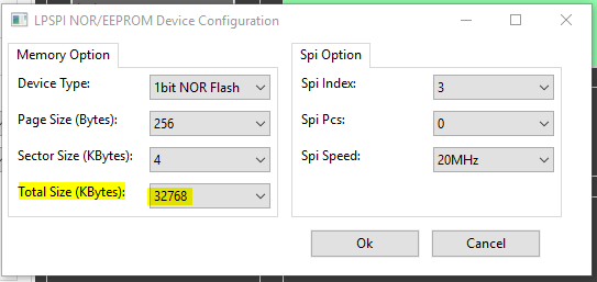

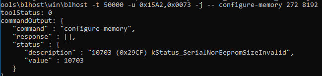

julio_delgado
Hello Kerry

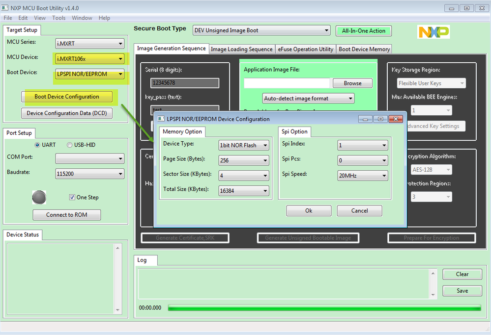

I'm using a 32 Mbytes memory, I attached photos of my configuration and error logs.
Question: Do you have the LPSPI Configuration Option Block?
Configuration:
Error using MCU Boot Utility:
Error using blhost tool manually;

You said: I'm still getting issues as the tool seems to support only 16Mb, whenever I try to setup a bigger memory I get this error.
Do you mean, if you choose this configuration with the same hardware:
Then you don't have problems? Is it right?
If yes, please also share your 16M log?
kerry

julio_delgado
Hello Kerry,
The LPSPI instance should not be the problem, I'm using a 32 MB connected to LPSPI instance 3 for all my testing.
I'm using a 32 MB memory with both configuration, and the only change I do is select between 16 MB or 32 MB on the Boot Device Configuration.
  • when I configure the MCUBootUtility to work with a 16 MB memory (Although it is 32 MB in real life) it is properly configures and I can work with that memory but only the first 16 MB.
    • Log from tool: 16MB_log.txt
    • Log from Cmd window on bakcground: 16MB_NXP-MCUBootUtility_Cmd_Window.txt
  • when I configure the tool to work with a 32 MB, without changing any of my schematic, I get the kStatus_SerialNorEepromSizeInvalid error message and I'm not able to work with the memory.
    • Log from tool: 32MB_log.txt
    • Log from Cmd window on bakcground: 32MB_NXP-MCUBootUtility_Cmd_Window.txt

kerryzhou
Hi Julio Delgado,
   Thank you for your updated information.
   Please tell me, what the detail nor flash you are using? 32 MB flash is which chip part number?  IS25WP128?
   Please note:  IS25WP128 is the 128Mbit=16MByte.
   And in the MCUBootUtility, the total size is KByte, not Kbits.
  So, if you are using IS25WP128, actually it is 16MByte,  then you need to select 16384.
  But if you are using IS25WP256, please also let me know, then I will need to check it with our MCUBootUtility tool author.
Kerry

julio_delgado
Thank you Kerry, it helped a lot.
I'm still getting issues as the tool seems to support only 16Mb, whenever I try to setup a bigger memory I get this error:
10703 (0x29cf) kStatus_SerialNorEepromSizeInvalid
My guess is that it is related to the 4-byte addressing that a memory bigger than 16MB requires. But I'm not able to find where can I setup this change.
Could you please help me to figure out the issue?
