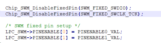

On my custom board, I need to enable PIO0_20 pin GPIO function. But I could not manage to enable it. Could you suggest the correct way ?

I already know hot to use GPIO on LPC15xx. My question was a little more specific about the pin PIO0_20 which has got a special function for hardware debugging ( SWDIO). I need to disable this function and use that pin as GPIO.
I already, disable the fixed function of PIO0_20 with following values given below  and enabled GPIO pin function. But the pin does not give any response at all. So, I thought I am missing something and asked the question.
#define I2C0_MASK ~( (1 << 3 ) | (1 << 4) )
#define RESET_PIN_MASK ~( (1 << 21 ) )
#define PINENABLE1_VAL (0xFFFFFFFF & I2C0_MASK & RESET_PIN_MASK )
LPC_SWM->PINENABLE[1] = PINENABLE1_VAL;

aykut_kocak
Dear Alice_Yang‌,
Yes SWM clock is already enabled. Other SWM setup is working fine, indeed.
I had attached the board_sysinit.c in the first post. You can check from that file.
Rgrds.
Aykut

Hello Aykut,
How do you know it doesn't work ?
 I haven't LPC1517,  while I test on LPC1549, it can work well.
After I configure the PIO0_20 to GPIO, can't debug project . I measure the PIO0_20 pin, it works well as my
code.  On my code, toggle this pin in a timer interrupt, the PIO0_20 can out put low - high - low -high... as GPIO.
#define PORT_MASK       ((1 << 0) | (1 << 1) | (1 << 24)|(1<<20))
void SysTick_Handler(void)
    uint32_t states;
    /* Get current masked port states */
    states = Chip_GPIO_GetMaskedPortValue(LPC_GPIO, 0);
    /* Toggle all the states */
    states = ~states;
    /* Write states back via masked set function. Only the enanled
       (masked states) will be changed. */
    Chip_GPIO_SetMaskedPortValue(LPC_GPIO, 0, states);
#define PINENABLE1_VAL  ((1<<13)|(1<<23))
In main()
    Chip_Clock_EnablePeriphClock(SYSCTL_CLOCK_SWM);
    LPC_SWM->PINENABLE[1] |= PINENABLE1_VAL;
I configure the code  based on "periph_gpio" demo under LPCopen.
I also checked your board_sysinit.c file , it seem there is no error, just disable the SWDIO pin two times:
TIC
