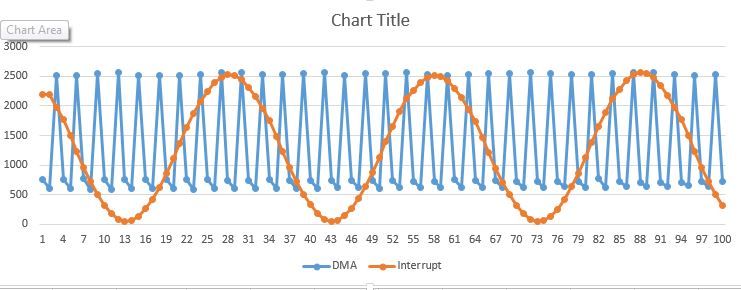

I am trying to verify the ADC speed with the LPCXpresso54608 eval board.
I stated with the lpc_adc_dma example and then modified the dma to have a linked list of 100 descriptors which then places the ADC data into an array of 100.  I set the ADC to be in burst mode .  I then send in a 100KHz sine wave, but what I receive looks like the ADC is sampling at maybe 400KHz, versus the 180 / 3 =  60MHz that I set it to.
Is there a better way to do this.
see attached file

I did switch to interrupt based and was able to verify the ADC is sampling at ~60MHz.
But when I switch back to DMA control it does not sample as fast it is ~30 times slower.  When I input a 100KHz signal I get ~30 samples using IRQ, but only get 3 when using DMA.Capture.JPG
What could be going on here?

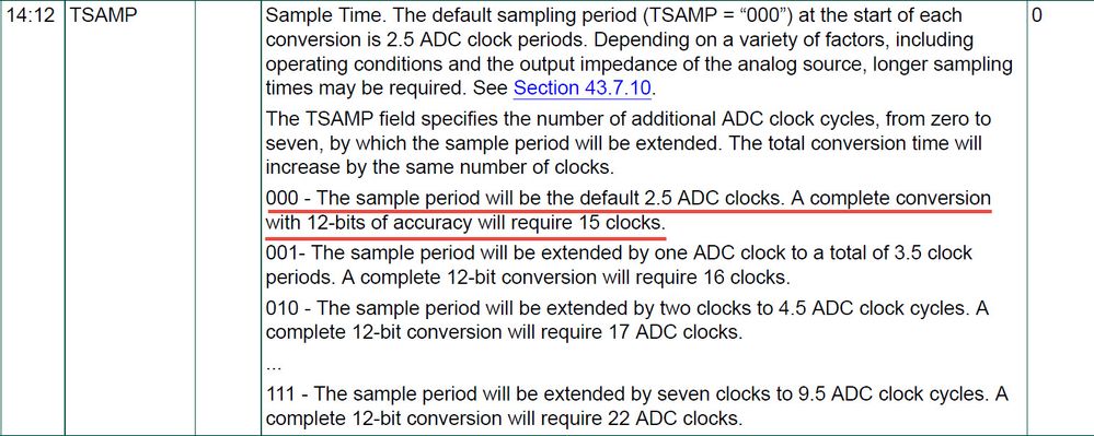

I was aware of the 15 clock cycles, which would should make the ADC sample rate 4MHz not 400KHz.
The 400KHz implies the ADC is running at 6MHz.
Based on the end code that I am trying to run, if I can get >5MHz sample rate my design will work fine.

After review your code, I get that ADC resolution is 12 bit, and sample time configuration is 0x0, which means complete a conversation will need 15 ADC clocks, then sampling frequency can be calculated via following formula.
F= 60 MHz/15= 4000 KHz.
