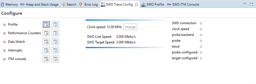

Hello Bryan,
Hope you are doing well.
From my understanding to your question. You would like to use the onboard LPC4322 and enable the SWO Trace capabilities for the LPC55S69 EVK board, is this correct?
Eanbling the following windows?
If so, please let me know so that I can guide you through the process.
Sabina

Sabina,
Thank you for your reply! No, that's not our question; we know that we can enable SWO via the IDE -- we need to be able to enable SWO outside of the IDE for purposes of development, debugging, CI/CD and so on. Normally, CMSIS-DAP would be the vector for this, but the firmware (incorrectly) reports that it has no SWO capabilities via CMSIS-DAP. So we are really asking for documentation around the interface that we know exists (that is, the interface used via the IDE) or LPC-Link2 firmware that correctly reflects (and allows for operation of) its SWO capabilities via CMSIS-DAP.
Thanks again for your reply, and in advance for any help you can offer!
