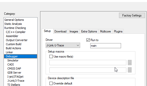

Could you please check if the debugger setting is set as J-link?
Aldo.

I'm using the I-Jet as my debugger and it is selected in my debugger settings.
