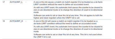

We added the line LPC_SCT0->CONFIG |= (1<<17);  //this is the autolimit flag
as you suggested.  The PWM routine now works.
The .h file needs more entries.  The AN11538_SCTimer_PWM_Cookbook v5.0.pdf. also mentions this flag but without explanation.

The Auto limit register is in  SCT configuration register-> AUTOLIMIT, have you config it?
Alice

Looking at SCT_11U6x.h :
The .h file that is in our download does not mention AUTOLIMIT_L.  The closest topic I found had to do with setting the SCT count itself.
