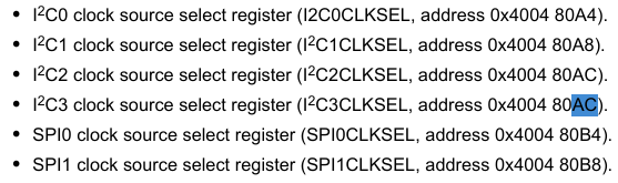

There exist functions like
uint32_t CLOCK_GetUart0ClkFreq(void);
in the actual fsl_clock driver, but not for e.g. SPI or I2C.
Also register definitions for UARTxCLKSEL, I2CxCLKSEL and SPIxCLKSEL are not present (I would assume in LPC845.h).
By the way: There is a c&P-error in UM11029, 8.6.26:
It must be B0 instead of AC.
I have reported this copy and paste error.
Thank you!
