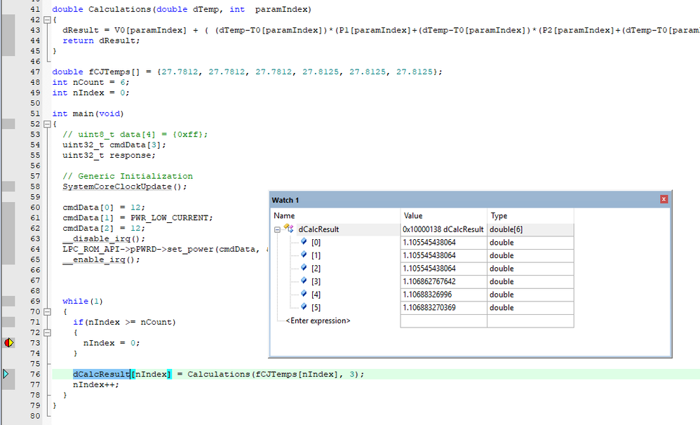

Dear NXP Community
I use the low current mode of the LPC824 in my application. But it seems that doing this, makes calculation with double faulty...
I call a function that has a formula with 8-9 coefs (double) with an input value (Double). The function also return double. With some values, the result is alternating each time i call the function. With other values it is ok. Also the calculated values can be a bit of the correct ones.
When I disabling the low current mode there are no problems.
// Low power mode
cmdData[0] = 12;
cmdData[1] = PWR_LOW_CURRENT;
cmdData[2] = 12;
__disable_irq();
LPC_ROM_API->pPWRD->set_power(cmdData, &response);
__enable_irq();
My question is. How can the low current mode has impact on the calculation of float/double and have this strange behavior?
I'm pretty sure the early prototypes we did not behave like this.
I have attached a small project demonstrating this behaviour. It is for KEIL MDK v5 and the source code below
Test with low current mode:
LoopFunction Input dResult
127.78121.105545438064
227.78121.105545438064
327.78121.105545438064
427.81251.106883269864
527.81251.106883269864
627.81251.106883270273
The result for loop 4, 5 and 6 the resulting value is alternating (loop 4 and 6) and the value itself is a bit off.
Loop 1-3 is correct.
Removing the low power mode, no result is alternating and the value itself is spot on
Maybe this behaviour is expected using low current mode?

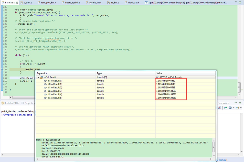

Hi Thomas Johansen,
I'd like to share my testing result.
Demo: periph_flashiap demo from LPCOpen library.
Board: LPCXpress824 MAX board
I've ported your code in the periph_flashiap demo which is from LPCOpen library, then run this demo on the LPCXpresso824 board, as the Fig 1 shows, it works well.
I've attached the code, please check it.
Fig 1

thomasjohansen
Hi TIC,
Thanks for your efforts.
I have not tried you sample from LPC Open because I have KEIL MDK.
I have just run my test code again and this is my result:
As you can see the values at index 3, 4 and 5 are different and off the correct value.
Could there be some batch difference with the LPC824? Compiler environment?
Thomas

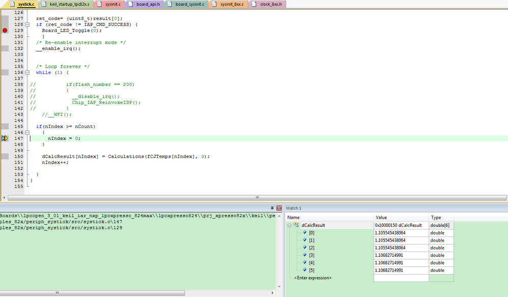

jeremyzhou
Hi Thomas Johansen,
It encountered some error when compiling your demo code, so I've ported the code to the periph_blinky project in the LPCOpen library and it works well, I've also attached the code, please check it.

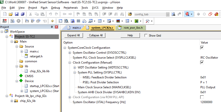

thomasjohansen
Dear TIC,
I have tried few things here.
I tried the Example_UART0_Terminal sample from the LPC824_Example_Code_Bundle_KEil_r1.0.
Also here there is a bit problem running the code. But It seems to have something todo with the PLL (MSEL value)
I change the MSEL value from 1 to zero, it seems to be ok. When I change it back to 1 it start calculating wrong
Could it be something wrong with the PLL setting that could lead to this behavior?
I also tried the the  periph_blinky from the LPCOpen library(It also has KEIL project in the bundle).
As you also see, there are no problems there. But that also run with completely different PLL settings.!!
Thomas

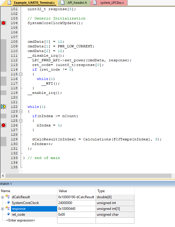

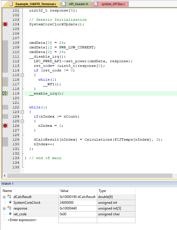

thomasjohansen
Hi TIC,
Yes, you where right. Is is the use of inconsistent clock frequency in the set_power mode.
But the bad part is, that doing a error check to not catch it. The result is always IAP_CMD_SUCCES
Please these two pictures. The first is with wrong clock in the params (12 instead of 24).
The calculations here are wrong, but the result from the set_power is still 0 (IAP_CMD_SUCCES)
In the other picture the correct value of 24 is used. Here the calculation are fine, but the result from set_power is still IAP_CMD_SUCCES
So it can't be detected??
Wrong clock params:
Correct clock param:
Thomas
