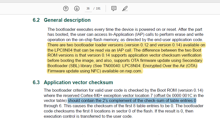

     LPC8N04 have two bootloader versions, please check these details:

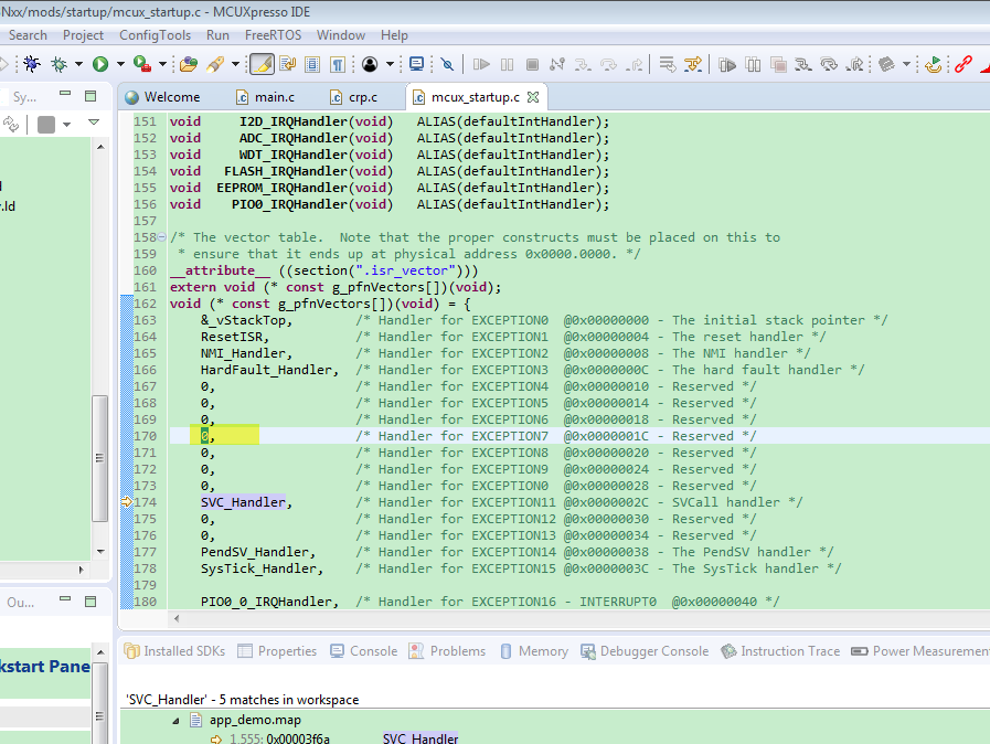

     So, you can add the vector checksum on your project, it is in the vector table, 0x01c:
Wish it helps you!

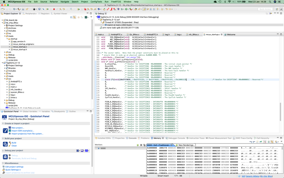

Thanks for your response. It doesn't state how the checksum is calculated. I take it this is NXP specific.Screenshot_mcux_startup.png
Attached is a screen shot of my attempts to enter a correct checksum in the mcux_startup.c and also shows the values of the first four entries in the vector table (0x10001FF0, 0x1DD, 0x23E9, 0x23E9), can you give a specific value for the checksum from this information?
3,453 Views
kerryzhou
Hi Harry,
    Please try 0XEFFF9661 as the checksum on your side.
