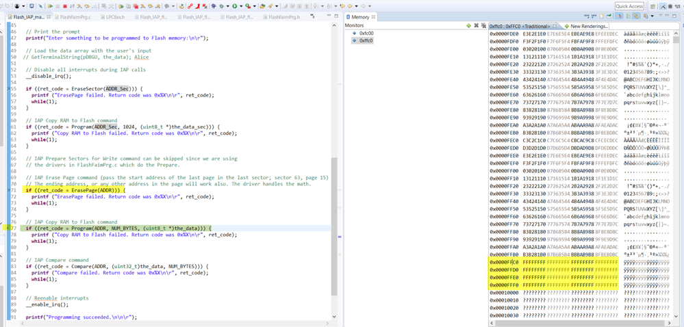

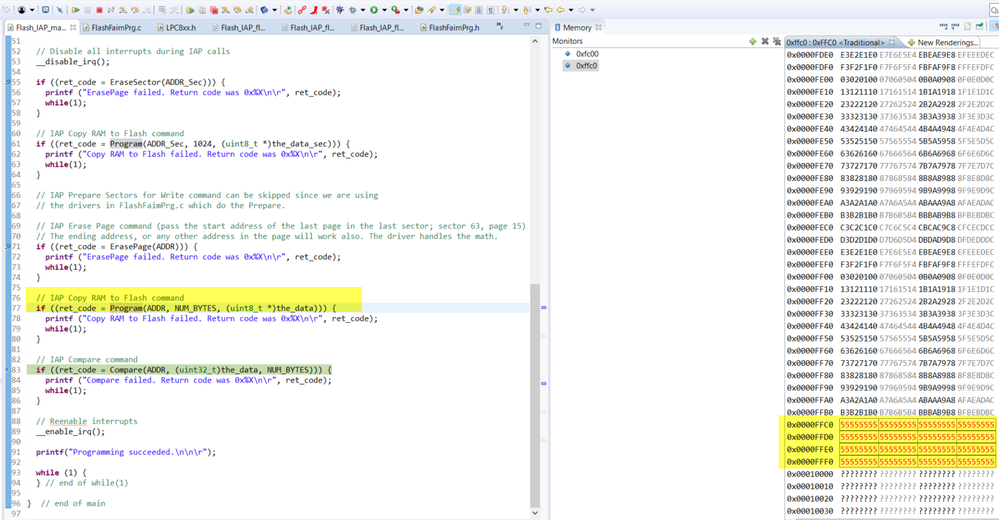

-> No, only erase the page. There is  "Flash_IAP" demo under LPC845 Code Bundule :
LPC84x 30MHz|Arm® Cortex®-M0+|32-bit Microcontrollers (MCUs) | NXP
I did some change to test based on this demo, confirmed  page erase function:
After erase page:
then writhe this page:
2) Before access FLASH , please disable all interrupts.

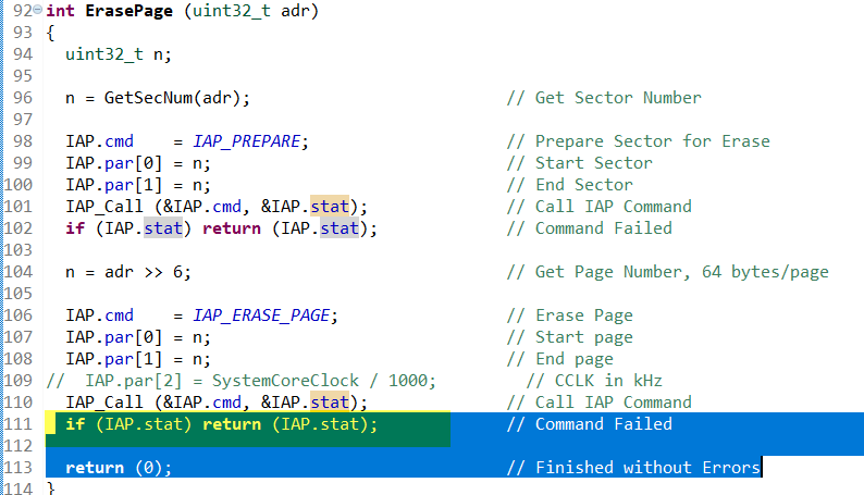

Hello Rian,
The IAP commands all have return Status,
we can  check the Statue code to confirm whether  finished:
