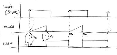

Right after clearing the CTRL::HOLD bit flag (in order to start the timer), the CTRL::STOP bit flag is automatically set, and there's no way to clear it!
This same application runs nicely on a LPC812MAX board:
A synchrony signal is shown on yellow color, while an output signal is shown in blue color. What I'm trying to achieve is (which I've already done it in the LPC812 uC):
The problem with the LPC812 is that you forgot to include an ADC, so for my application I needed to find a similar device.
Now, what's the problem with the LPC824? Let me show you the last instruction after the timer has been configured:
