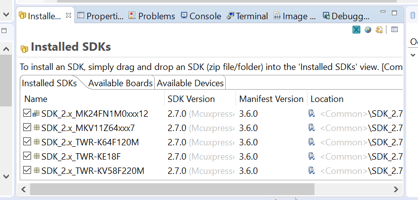

The LPC8xx and LPC54xxx family start implementing what we know as SDK, this is the newer version of LPCOpen and you can download it from here:
Welcome | MCUXpresso SDK Builder
This package has examples and all the drivers need it to start working in your application, the structure is a little different from the LPCOpen but is very intuitive and the examples give some advice, to install the SDK you only need to drag and drop to the following tab:
Let me know if this helps you.
