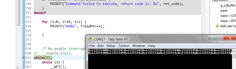

Hi Everyone,
Im currently using the SDK Version: KSDK 2.4.1 (2018-06-18) for LPC804 ,
Please help me to write data in Flash memory , im not finding any example for the same.
Ashok

Hi Alexis,
Thank you so much. I tested the code with LPC804 and working fine and verified OK  :smileyhappy:

dear ashok, can you please post how to read the value from the flash memory ?
