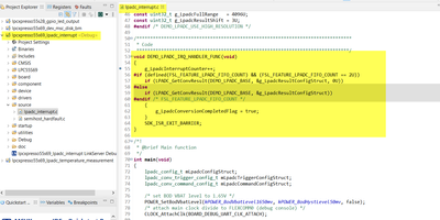

When the SDK creates a project, it creates over 60,000 lines of code. I have searched for ADC0_IRQHandler in most of the logical places it could possibly be, but can't find it.
4,494件の閲覧回数
For example lpadc_interrupt demo:
