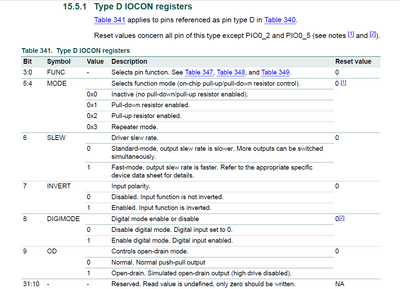

I2C on Flexcomm2 using PIO1_24 as SDA and PIO1_27 as SCL results in a non-functional setup, while I2C on Flexcomm2 using PIO1_24 as SDA and PIO1_25 as SCL results in a functional setup.
Why does it not function with PIO1_27, while the MCU config tool indicates legitimate setup?

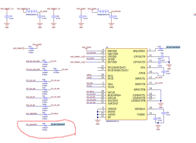

I think the pin configuration is correct.
On the LPC5528-EVK board, the PIO1_27 is connected to the codec, I do not know if it takes effect on the feature of PIO1_27, pls remove the R24 and have a try.

2,785 Views
xiangjun_rong
Pls refer to the IOCON module, I suppose that you have to set the OD bit(bit 9) and the DIGIMODE bit(bit 8), and connect external pull-up resistor.
Pls have a try
XiangJun Rong

2,767 Views
xiangjun_rong
Hope it can help you
XiangJun Rong
2,730 Views
lsl
Hi XiangJun,
                     this was the issue. It now functions.
Thanks!
