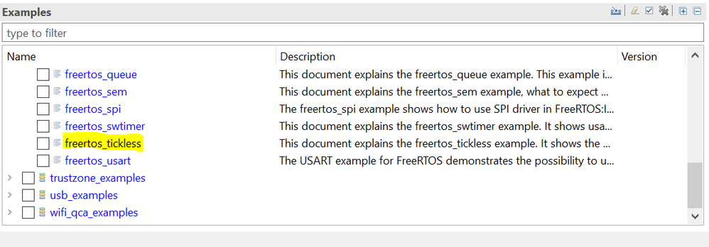

There is an example in the SDK for the LPC55S69, that demonstrates the use of tickless FreeRTOS.
