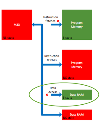

Hello greys_mayf,
If you want to Trustzone function, recommend first refer to the "Chapter 47: LPC55S6x/LPC55S2x/LPC552x Trusted Execution Environment" of um11126.
You can see cpu in NS state can't access the data in Secure part:
