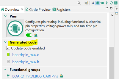

RaRo
Hello @BertrandR,
First of all, welcome to the community.
Related with your question, ConfigTools only modify certain parts of your project, not all of it.
ConfigTools -> Peripherals only modify board\peripherals.c and board\peripherals.h; ConfigTools -> Clocks only modify board\clock_config.c and board\clock_config.h; and ConfigTools -> Pins only modify board\pin_mux.c and board\pin_mux.h. You can watch what part of your code are you generating in ConfigTools -> Overview -> Generated code.
The line you are missing is at main, so any of your ConfigTools configuration won't generate the disable LDOGPADC power down line [POWER_DisablePD(kPDRUNCFG_PD_LDOGPADC)] in your project.
