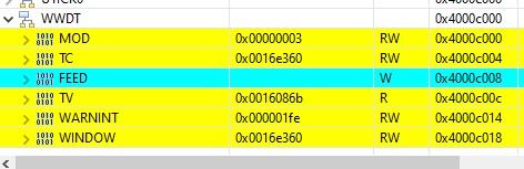

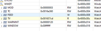

I have tested your code, these are the register value of WDT.
It appears that you do not set up the WINDOW register, but you use the delayWwdtWindow() condition to feed dog.
am I right?
Note that the WARNINT reg is a 10 bits register
void delayWwdtWindow(void)
/* For the TV counter register value will decrease after feed watch dog,
* we can use it to as delay. But in user scene, user need feed watch dog
* in the time period after enter Window but before warning intterupt.
while (WWDT->TV > WWDT->WINDOW)
__NOP();
You have to set up the TC,WINDOW and WARNINT registers to a proper value. so that the TV can reach down to the WARNINT reg.
Pls try to set up the above three reg to a proper value.
Hope it can help you
Regard
XiangJun Rong

I have changed now the settings to:
config.timeoutValue = wdtFreq * 6;
config.warningValue = 510;
config.windowValue = wdtFreq * 6;
So this are the set values:
What i want is that before the processor is resettled that the WDT_BOD_IRQHandler is called and i can do some things before the reset.
Can you give me some example how can achieve that?
