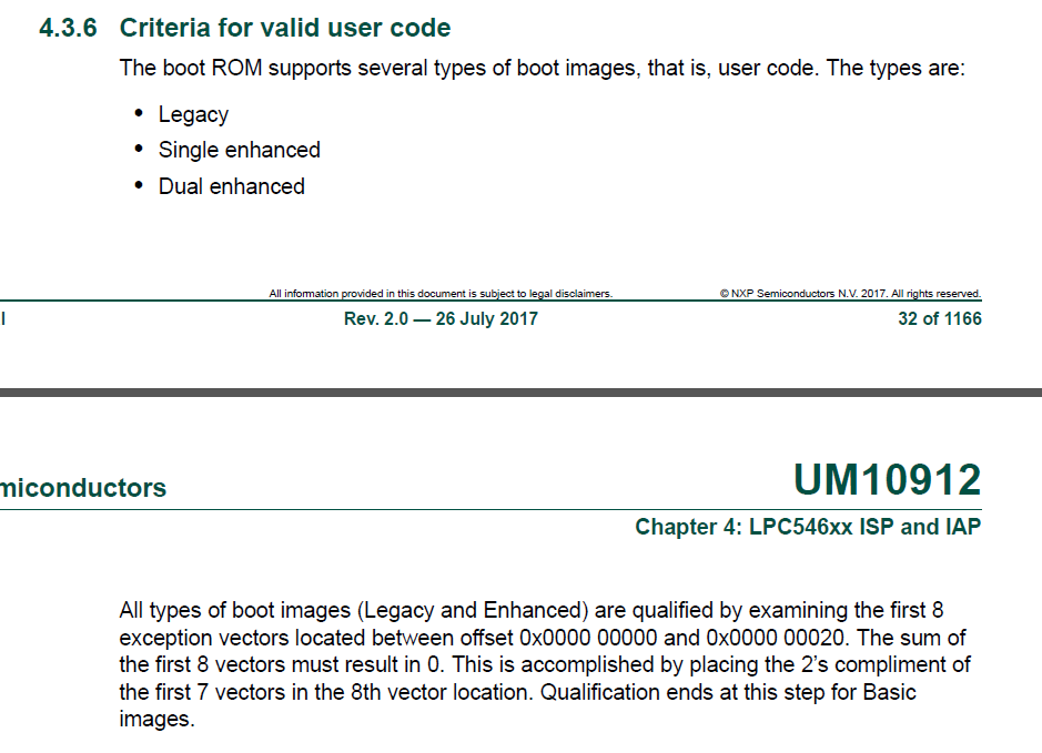

i am working on a project which is combine with a secondary bootloader and APP. bootloader used address 0x0000-0xFFFF(flash sector 0-1), APP used address 0x10000-0x7FFFF(flash sector 2-15).
i have made a function to update bootloader code on ROM when APP is running by using IAP function, which is same like bootloader update APP code.
but i got a 2521 return code when using below function:
void WriteNewBootloader ( void )
    uint32_t status;
    uint16_t i = 0;
    uint8_t BINbuffer[FLASHWRITEMAXSIZE] __attribute__ ((aligned (4)));
    __disable_irq();
    for ( i = 0; i < (( 0x10000 ) / FLASHWRITEMAXSIZE); i++ )
		memcpy ( BINbuffer, ( uint32_t * ) ( 0x70000 + i * FLASHWRITEMAXSIZE ), FLASHWRITEMAXSIZE );
        FLASHIAP_PrepareSectorForWrite ( 0, 1 );
        status = FLASHIAP_CopyRamToFlash ( 0x00000000ul + i * FLASHWRITEMAXSIZE, ( uint32_t * )BINbuffer, FLASHWRITEMAXSIZE, SystemCoreClock );
        PRINTF ( "[Board]FLASHIAP_CopyRamToFlash status %d.\r\n", status);
		status = FLASHIAP_Compare ( 0x00000000ul + i * FLASHWRITEMAXSIZE, ( uint32_t * ) BINbuffer, FLASHWRITEMAXSIZE );
        if ( status != kStatus_FLASHIAP_Success )
            PRINTF ( "[Board]FLASHIAP_Compare failed.\r\n" );

so i had read out the datas from 0x0000-0xFFFF. there were all "0xFF" in 0x0000-0xFF0, and others address data were right.
but if i changed the target flash sector to 12-13, address 0x60000-0x6FFFF. the function worked well, and i could read out right datas on this address.
I want to know whether address 0x0000 can be used in IAP function to write in data, or somewhere I used these function in a wrong method?

Thanks for your reply. And I just solved this problem.
I called this funtion after hardware initialization finished.
NewBootloader bin was set in 0x70000-0x7FFFF. the target address is 0x0000-0xFFFF.
I had read the UM10912 carefully, and I found below specification. mu10912.PNGmu10912.PNG
So I changed one word data 0xDFFD6728 at offset address  0x001C in my NewBootloader bin, which was 0x0000000. Wirte the first 7 words checksum in ROM address 0x0000001C to satisified to the rule.
After that, the function worked well. Thank your again.
