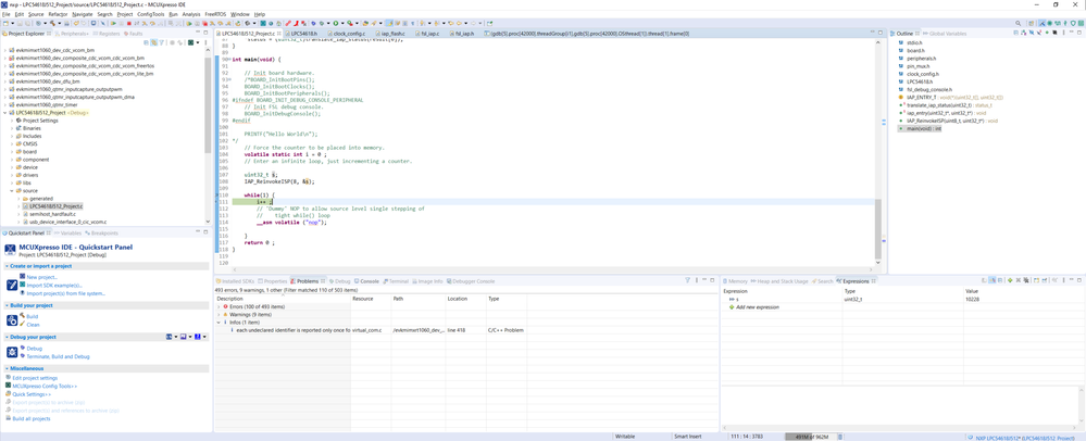

Hello. I need to boot to hardware DFU USB0 from user app.
I found solution here: https://community.nxp.com/t5/LPC-Microcontrollers/REinvoke-ISP-IAP-with-LPC54608/m-p/987677
Problem is when i try to jump when USB cable is detached. Look:
i tried to launch IAP_ReinvokeISP(8, &s); inside loop, but it always return 10228. I want to launch dfu after cable attached, if it can`t before. So now i can launch dfu only if cable attached correctly.

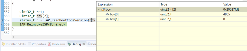

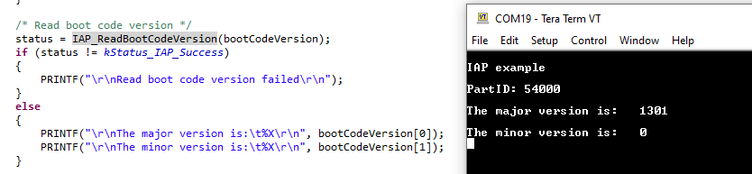

We could check the ROM bootloader version  by calling the function IAP_ReadCodeBootVersion()
I will come back to you later with further feedback on your issue.
Diego .
4,111 Views
dinartal
It looks like minor version is 0 and major is 4865

I think that I have replicated your error with my LPCxpresso54608  :
  • If I try reinvoke  using USB0  , without a cable attached,  I get an 10228 (Reinvoke ISP not successful ).
  • On the other hand if I reinvoke while having the cable attached, I am able to perform DFU.
Could you please  provide me the version of the bootloader that your LPC54618 has?
I am currently checking this, and I will get back to you.
