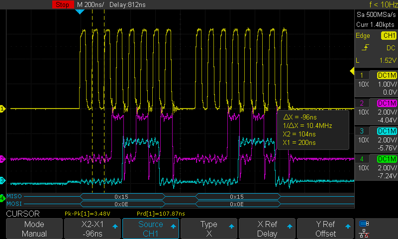

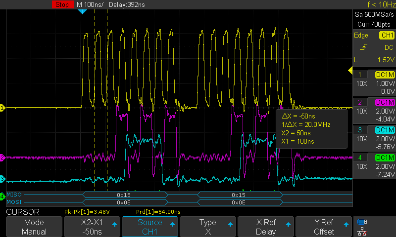

I use the LPC4327 to be the SPI Master and use DMA to transfer DATA.
The oscilloscope shows the correct data return by our Slave as beflow.
Yello: SCLK Purple:MISO Blue:MOSI
10 Mhz:
10 Mhz10 Mhz
21Mhz:
20 Mhz20 Mhz
Both return value for 10 Mhz and 21Mhz is 0x15. But the DMA transfer rx buffer give me 0x0A for 21Mhz clockrate(Right shift 1 bit) and 0x15 for 10 Mhz(correct with oscilloscope).
I have checked the SPI mode for master and slave is same(CPOL0 CPHA0).
The spec shows maximum SPI data bit rate is 25 Mbits/s for LPC4327.
Why do I get a shift value for the high speed clock rate?
Do I need to set something for the high speed clockrate?

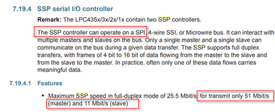

Hi, d016808
May I ask if you use LPC4327 as SPI DMA Transfer, which communication mode do you choose, SPI or SSP? The SSP controller can operate on a SPI, but for transmit only 51 Mbit/s (master) and 11 Mbit/s (slave).

I choose the SSP1 controller, and LPC4327 as master mode. I think set the SPI clockrate 21 Mhz has met the spec.

Actually, I have tried to use polling mode instead of DMA. But the data still shift 1 bit.
3,117 Views
Xu_Zhang
May I ask what Slave you use in the data transmission process? Is it also LPC4327? Is it convenient to provide specific 21Mhz problem demo, so that we can better solve the problem for you.
Xu Zhang
3,085 Views
sd016808
The device is not LPC4327. It is a device that we developed. Is there any possible reason why the oscilloscope shows the correct waveform, but the DMA transfer receives shifted 1 bit data in the same SPI mode?
I have tried connecting the LPC4327 MISO and MOSI pins to assess the situation. When I connect them, I can run at 25.5 MHz with the correct data. However, when I increase the speed further, the data starts to shift to the right. I believe this situation is within the specifications.
I compared the waveforms for the pin-to-pin connection and the pin-to-our-slave connection, and observed a slight delay in the slave output wave. I suspect that this delay may be due to our slave output being too slow for the LPC4327 operating at 21 MHz. What is the minimum required setting time for the LPC4327 at 21 MHz?
