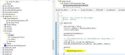

If yes, could you try the periph_adc  example with this modification?
That is : After the ADC channel has been enabled call App_Polling_Test(); function, avoiding all the following part of the example.
In my case, I am currently able to debug with the LPC1769, its ADC has less features than  the  LPC407x , but they share the same adc_17xx_40_xx.c driver.
I was able to get the ADC conversion ( exit the while(Chip_ADC_ReadStatus)). I have also hardcoded the burst flag, to do a quick test of your setting with this mode. Apparently it worked on my side.

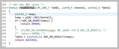

 * Check the return value for the  function readADC val.
Are you getting an error? No valid conversion results for any  ADC channel?

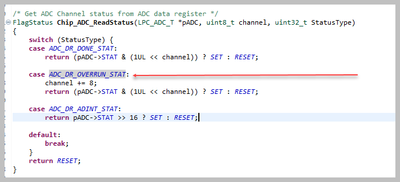

* And Check the return of the function  Chip_ADC_ReadStatus()  for the ADC_DR_OVERRUN_STAT status
To see, if you are getting an overrun status as you enabled  burst mode.
