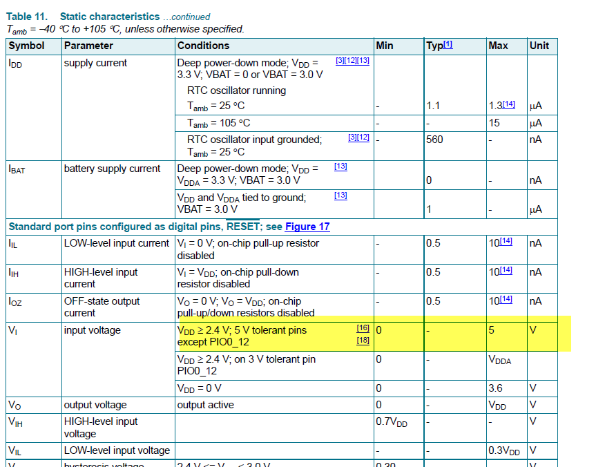

    About the 3.3v and 5V problems. I think this may have problems. The standard IO is 5V tolerant pins except PIO0_12.
So, please check your input voltage with oscilloscope, is it over 5V?
Please also check your slave I2C, if the master give 3.3V to slave, can it recognize it as high?
This is very important.
Normally, you can use the convert module to make the I2C signal at the same requirement, don't mix 5V and 3.3V signal together.

Regarding the 5V pin tolerance: I do not think this will be an issue. You mention that pin PIO0_12 is not 5V tolerant, but only PIO0_22 and PIO0_23 are used for I2C on 5V. The SCL and SDA lines are externally pulled-up so that a slave will receive correct line levels.
