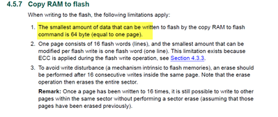

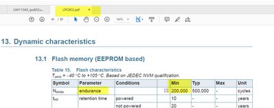

Can someone at NXP please help me fill out this table?  I'm trying to port my EEPROM emulation algorithm to support several LPC chips, and they seem to behave differently, even within the LPC8xx series.
Also please point me to the documentation of this if it exists.

BTW, I've already found out that I can't write to the flash in units smaller than 64B page on LPC804: https://community.nxp.com/t5/LPC-Microcontrollers/LPC804-write-flash-single-word/m-p/1400358
A follow-up question:  Based on my observations with LPC804, it seems that it is unnecessary to call "Erase page" before call "Copy RAM to flash" since the latter seems to erase the page before programming anyway.  Is it recommended or would it count to unnecessary Prog/Erase cycles?  Is this true for all LPC variants, or just LPC804?

Hello @phatpaul
1. About erase/program size, you can find in RMs, for example lpc802:
 2. For "endurance", can find in DS:
3 "Is it recommended or would it count to unnecessary Prog/Erase cycles?"
->> Recommend erase before program, you can refer to  IAP_FLASH demo under SDK, download SDK from: https://mcuxpresso.nxp.com/en/select
