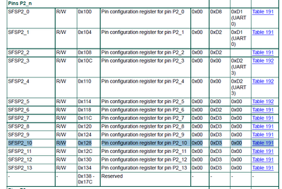

Hi NXP,
I am using the LPC Link2 as a dev board and am trying to print data to the USART2 pins, and read the data with an FTDI serial cable to a Mac computer running PySerial. My computer is also running my Link2 code on MCUXpresso which is simply sending test data using UART functions I sourced from embedded artist.
I have read some other posts about the USART2_Rx and Tx pins on the Link2 but they aren't exactly clear about whether the USART2 pins work or not. I haven't been successful in getting any data yet.
Can someone tell me if my setup will yield results? Please let me know if you need more information about my cables, code etc.
-Quinn

As you know that the USART2_TX is multiplexed with PIO2-10, CTOUT_2, EMC_A1, so you have to write SFSPF2_10 as 0x02 so that the P2_10 pin functions as usart2_Tx pin.
Pls refer to the following screenshots.
XiangJun Rong

Ok so I think I have my pin settings correct now. P2_10 was set to Function 0 for some reason. This is now function 2 for the UART_TX.
I have also tried disabling synchronous mode but still no luck.
