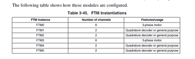

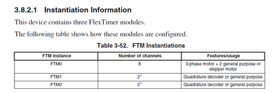

Okay, if you just want  M3 or M4 core processor, I suggest you consider Kinetis KV3x(Cortex-M4 core), the KV31 has 3 FTM modules, all of them can interface with Encoder.
This is KV31 Figure:
For KV11(Cortex-M0 core), this is KV11 FTM features:
Pls refer to Kinetis KV11 or KV31 from the link:
https://www.nxp.com/products/processors-and-microcontrollers/arm-microcontrollers/general-purpose-mc...
Hope it can help you
Xiangjun Rong
