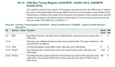

I'm using LPC1768 CAN peripheral and I want to set CAN Baudrate = 666.666 kbps but getting debug error - Failed to calculate exact CAN baud rate.
I'm able to set all standard Baudrates (250kbps, 500kbps, 1Mbps). So can you provide required clock settings and nominal time settings to set 666.666 kbps baudrate .

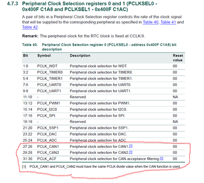

Secondly, the PCLK_CAN1, PCLK_CAN2 and PCLK_ACF bits must be the same value.
Thirdly, this is the CAN baud rate computation, assume the cclk is 100MHz, the required CAN baud rate is 666.66KHz, the divider will be
100MHz/0.6666666MHz=150
Assume that the PCLK_CAN1 bits are 2b'00, it means that you select CCLK which is 100mhz.
You set up the BRP as 14, the divider will be 15.
If you set up the TESG1 as 4, TESG2 as 3, the synchronization is assumed to be 1, the CAN baud rate will be
100MHz/((BRP+1)*( 1+TESG1+1 +TESG2+1)=100/[15*(1+4+1+3+1)=0.66666MHz.
Pls have a try.
