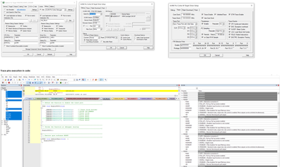

Hai,
I have the Ulink Pro debugger, I need to see execution profile using ETM in LPC1769 it is working fine while coming to the LPC54606 and LPC54608 hardware it is not working and showing no synchronization error. If possible please provide the test code for it.
Thank You,
B Pavan Kumar
3,015 Views
PK_1114
we try the above initializations and also initialization files also but it is not working.

PK_1114
We already terminate the ETM Trace Pins (TraceCLK, Trace Data0, Trace Data1, Trace Data2, Trace Data 3) in Debugger Connector and we are using Ulink Pro Debugger for tracing and Keil UV5. But it is not working.

xiangjun_rong
I suppose that your own code includes the pin assignment and the trace clock divider.
For example,the  PIO1_0 is assigned as Traceclk with func 5, for detail, pls refer to section Table 256. Type D I/O Control registers: FUNC values and pin functions in  UM10912.pdf
in pin_mux.c, add the code:
#defineIOCON_PIO_FUNC5
CLOCK_EnableClock(kCLOCK_Iocon);
const uint32_t port1_pin0_config = (
IOCON_PIO_FUNC5 |
/* No addition pin function */
IOCON_PIO_MODE_INACT |
/* Input function is not inverted */
IOCON_PIO_INV_DI |
/* Enables digital function */
IOCON_PIO_DIGITAL_EN |
/* Input filter disabled */
IOCON_PIO_INPFILT_OFF |
/* Standard mode, output slew rate control is enabled */
IOCON_PIO_SLEW_STANDARD |
/* Open drain is disabled */
IOCON_PIO_OPENDRAIN_DI);
/* PORT1 PIN0 (coords: B13) is configured as traceclk*/
IOCON_PinMuxSet(IOCON, 1U, 0U, port1_pin0_config);
//set the trace clock divider
 CLOCK_SetClkDiv(kCLOCK_DivAhbClk, 10U, false);
