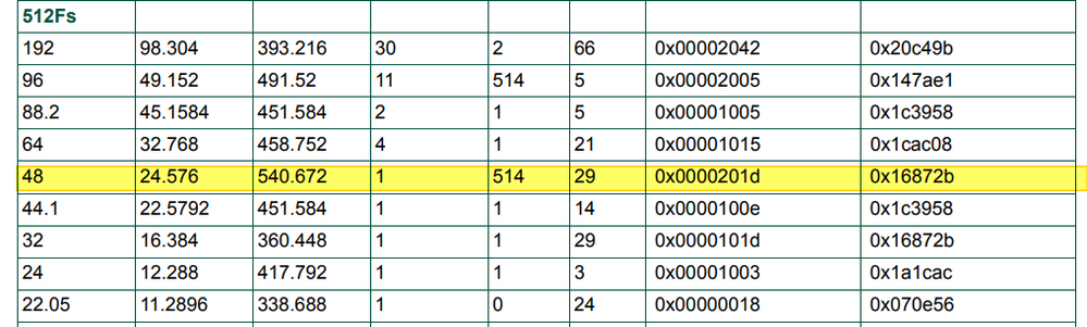

I am using om13088 development board, and try to configure clk0-pll0audio clock to 512fs where fs is 48kHz.
I am follow here to setup pll.
https://www.nxp.com/docs/en/user-guide/UM10503.pdf
Here is my configuration in board.c
static const CGU_USBAUDIO_PLL_SETUP_T audioPLLSetup = {
0x0000601D,
0x0 ,
0x0000201d ,
0x16872b,
24576000\

The output frequency with above setting is 48Mhz
Dose anyone have ideas about how to set pll0audio?

You can use the Audio PLL settings calculation tool please check the following link:
Audio PLL settings calculation tool.zip
In addition check the following link:
PLL0 PDEC calculation
