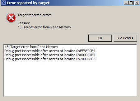

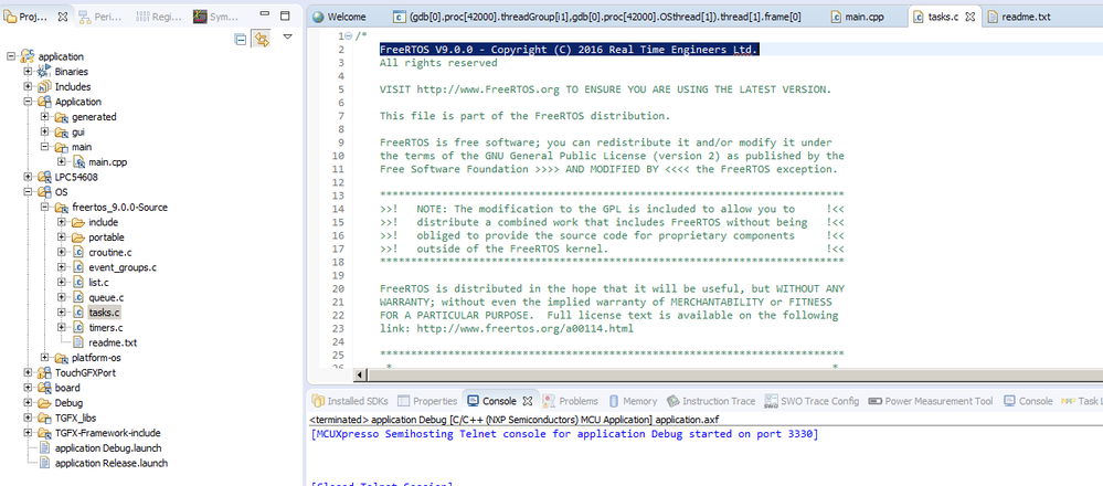

I get this error while debugging a freertos project. Breakpoints are working well, but when I go to the FreeRTOS menu and click on any button (task list, queue list, timer list or heap usage) the debugger crashes as follows:
I read this could be a power issue, but same happens when powered with a 1.5A supply.
I am using the LPC54608 evaluation board om13092 and the on board debugger on MCUXpresso.
Thank you for ideas!

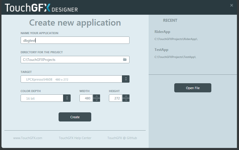

I made a step by step guide to reproduce:
1- Create new TouchGFX project - leave it empty and generate code

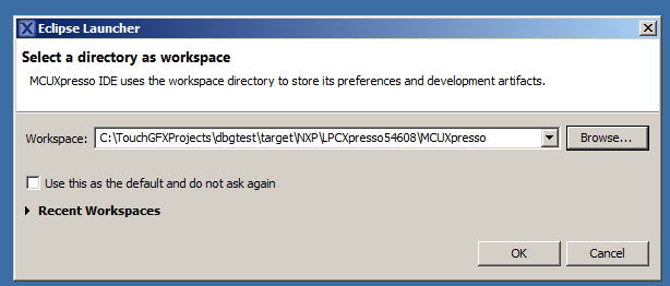

2- Open the Touchgfx project in Mcuxpresso:

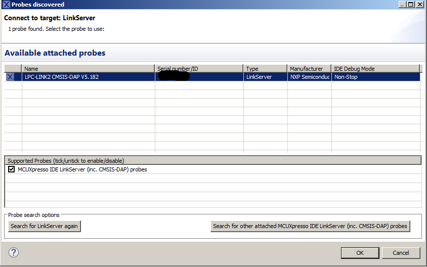

3- Run Debug 'application' from quick access menu:
4- Select the debug probe and click ok
5- Click run to jump over the first breakpoint and start the freertos tasks. Then suspend and goto FreeRTOS -> Task List. Get this error:

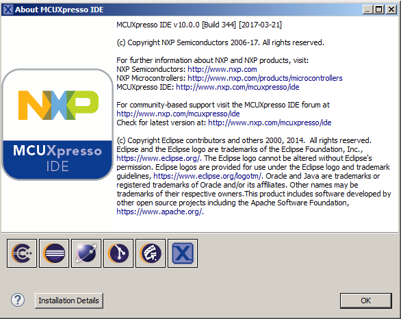

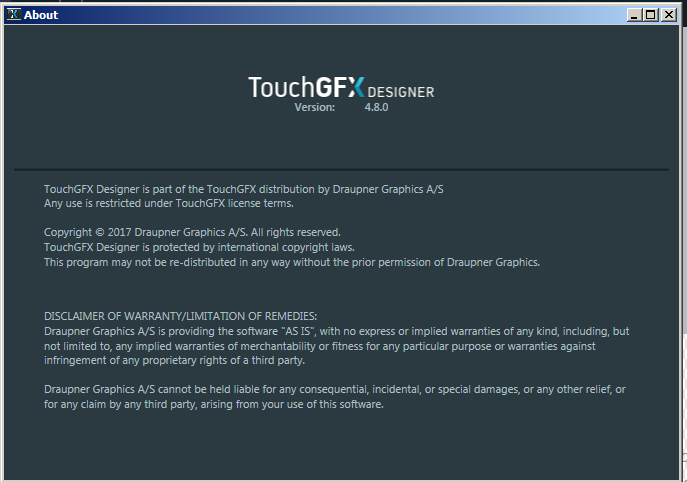

Versions Used:
MCUXpresso:
Freertos:
TouchGFX:
Thank you very much for your help!

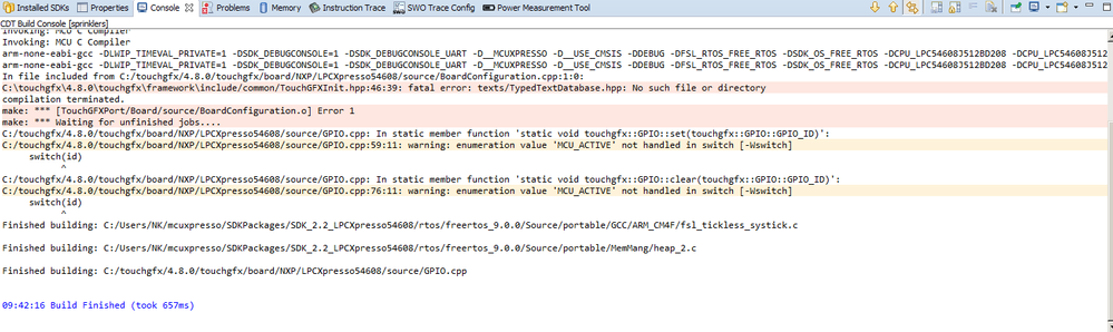

However I can't setup the NXP MCUXpresso by following the TouchGFX NXP LPC54608 Board Support Package - Installation V1.5.
After I edited the NXP_SDK_PATH and the TGFX_PATH, I compiled the application demo later, however some errors had been raised.
So I was wondering if you can share the sequence of setup the MCUXpresso.

Hello jeremyzhou‌, thank you for your reply. I also followed the instructions in "TouchGFX NXP LPC54608 Board Support Package - Installation V1.5" - so my .project file contains this:
<variable>
<name>NXP_SDK_PATH</name>
<value>file:/C:/Users/NK/mcuxpresso/SDKPackages/SDK_2.2_LPCXpresso54608</value>
</variable>
<variable>
<name>TGFX_PATH</name>
<value>file:/C:/touchgfx/4.8.0</value>
</variable>
I get the same error than you when I try to compile the Sprinklers demo. But after adjusting the SDK Path in the .project file in the sprinklers demo too, I get another error:
Texts/TypedTextDatabase.hpp: No such file or directory
It is not so important for me that the demo does not compile... I'm still having the problem that I can't see the FreeRTOS tasks while debugging an application made with touchgfx designer, I get the debugger error I pasted in my earlier post.
