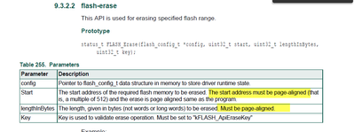

The terminology in the documentation for the LPC55S69's flash API and the MCUX driver is inconsistent and not well defined. What I'm trying to determine is the block size for erase and page program.
The driver itself reports a page size of 512 bytes and a sector size of 32768. For most NOR flash vendors I've used, erase operations are performed on full sectors and program operations are performed on pages. The FLASH_Erase() description says: "This function erases the appropriate number of flash sectors based on the desired start address and length."
To me that implies that it has to erase at least 1 sector, which would be 32k. That's not supported by other mentions in the docs, though, like the lengthInBytes parameter: "The length, given in bytes (not words or long-words) to be erased. Must be 512bytes-aligned."
This seems to say that 512-byte erases are possible. Can someone confirm that this is true? If so, what is the significance of the sector size? There's also a block size which seems to be the same as the total size.
Also, it's not relevant to the bootloader I'm working on today, but what is the minimum size that can be written, and its alignment? The driver says the length must be 512-byte aligned (I think that is trying to say that it needs to be a multiple of 512 bytes, not that the value needs to be aligned on a 512-byte boundary) but the user's manual suggests that 128 bits is the minimum write size. Can someone clarify that? It's useful to be able to perform many small writes to a previously-erased page to reduce the wear on the flash when updating values.

Hello @scottm
1, "The driver says the length must be 512-byte aligned (I think that is trying to say that it needs to be a multiple of 512 bytes,)"
->> Yes, the minimum size of program is one page (512 bytes), and can be multiple of 512 bytes.
2, "but the user's manual suggests that 128 bits is the minimum write size."
->> Could you please share me where mentioned this, i will help to check.
3, The minimum size of erase also is one page:
