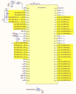

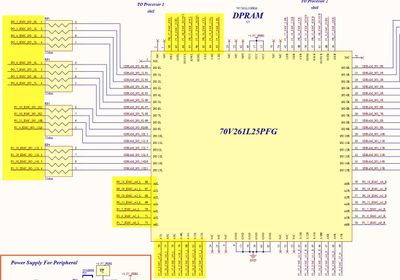

I'm trying to interface 16-bit external DPRAM (Dual Port RAM) 70V261 with LPC54628 using its EMC peripheral.
Query 1:
If data is read from the DPRAM immediately after a write, then all read operations are successful. However, if data is first written to DPRAM, some delay is inserted and then read operation is performed, most of the read operations fail. However, there is a fixed pattern between the value that is written to the DPRAM and the incorrect value that is read back. Basically,
Readback value = (original value that was written << 16U) + 0x0100.
Value that was writtenReadback valueEMC location (address, HEX)Diff between written and read valueDiff in HEX
0256 x80000000 256x0100
1513 x80000001 512x0200
2770 x80000002 768x0300
31027 x80000003 1024x0400

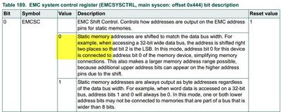

    SYSCON->PRESETCTRL[2] |= SYSCON_PRESETCTRL_EMC_RESET_MASK;
    SYSCON->PRESETCTRL[2] &= ~SYSCON_PRESETCTRL_EMC_RESET_MASK;
    /* Set the EMC sytem configure. */
    SYSCON->EMCCLKDIV = SYSCON_EMCCLKDIV_DIV(config->emcClkDiv);
    SYSCON->EMCSYSCTRL = SYSCON_EMCSYSCTRL_EMCFBCLKINSEL(config->fbClkSrc);
	// Added next two lines to modify EMCSYSCTRL to make the code work
	SYSCON->EMCSYSCTRL &= ~0x01;	// make LSB bit0 = '0', so that addresses are shifted to match bus width to ensure 1:1 relation between address lines
	SYSCON->EMCSYSCTRL |= 0x04;		// make bit2 = 1 to disable burst mode

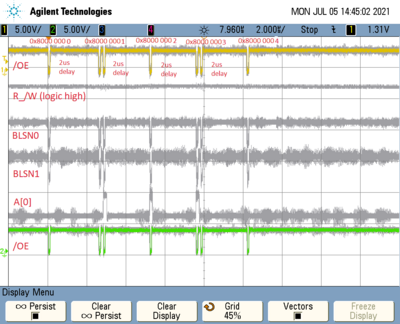

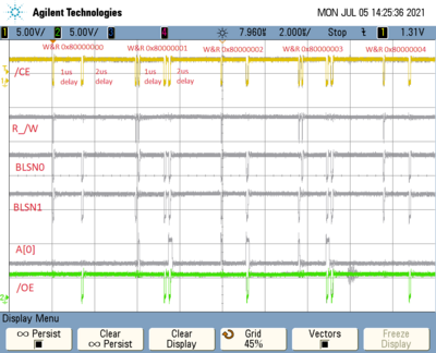

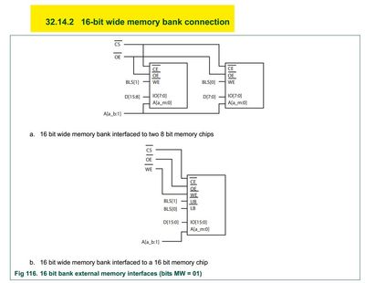

However, I configured the BLSN0 & 1 pins (Upper Byte & Lower Byte selection pins) as GPIO type and set it permanently to logic low since my DPRAM is 16-bit and my values are stored as 16-bit numbers. This improved the result substantially. Now all odd addresses are read back successfully while even addresses have the left_shift I described in the first post. I also tried to set the values for various delays manually by loading values into respective registers and printed the values to terminal, as can be seen from the code.
Configuration in brief:
16-bit width, little endian, core PLL frequency 96MHz, page mode disabled, active low chip select, byte lane state bit PB is high, extended wait disabled, buffer disabled.
Static memory addresses shifted to match data bus width (bit-0 of uC connected to bit-0 of DPRAM), burst disabled, EMC clock source is internal loop back from EMC_CLK output.

I was trying to find a solution and came across this in LPC54628 user manual:
The EMCSC bit in EMCSYSCTRL register controls whether the address output lines from the microcontroller is shifted to the right so that there is 1:1 match between the line nos of uC address lines and that of the external memory. As an example, it talks about 32bit memory chips where bit-0 of address line (A[0]) may be connected to bit-0 of external SRAM.
My query: What does this imply for 16-bit devices? If the EMCSC bit is cleared to '0' and there exists 1:1 match between A[0]:A[15] lines of microcontroller and A[0}:A[15}  address line of external memory, everything should work properly, right? The PCB tracks in my board have 1:1 mapping between address lines of uC and the DPRAM.
EMC_shift_control - Copy.JPGEMC_shift_control - Copy.JPG16-bit connection - Copy.JPG16-bit connection - Copy.JPG
9,527 Views
xiangjun_rong
For 16 bits data width memory connection, if you connect as the Fig 116 16 bit bank external memory interfaces, obviously, the EMCSC bit must be set, because A[xxx,1] of LPC54628 are connected to A[xxx-1, 0] of 16 bits SRAM(I mean that A1 of EMC is connected to A0 of 16 bits SRAM).
If A[xxx,0] of LPC54628 are connected to A[xxx, 0] for 16 bits data width memory, the EMCSC bit must be cleared(I mean that A0 of EMC is connected to A0 of 16 bits SRAM).
Hope it can help you
XiangJun Rong

xiangjun_rong
Can you share the SRAM schematics so that we can review the hardware connection?
Xiangjun Rong
9,443 Views
aswinprabhu
@xiangjun_rong
Thanks for the revert. PFA the schematics.
1) Pins P0_5  (PO_5_EMC_I/O_3L) & P0_6 (PO_6_EMC_I/O_4L) are connected only to the DPRAM. Mentioning this so that you do not get confused as to whether they are connected elsewhere also.
2) Pin P0_4  (PO_5_EMC_I/O_2L) is connected to a push button as shown at the bottom of the image and is also used for serial programming.
LPC54628LPC54628DPRAM 70V261DPRAM 70V261

@xiangjun_rong
Please find attached signals as probed on oscilloscope. All pins are configured as EMC (including BLSN0 & 1).
In the 1st image, write followed by read of the same location, with a delay of 1us in between is shown. This is done for the first 5 locations in DPRAM ie, 0x8000 0000 to 0x8000 0004 in EMC. Data is '0' to 1st location, 1 to 2nd, 2 to 3rd etc.
In the 2nd image, after running the write/read loop once as mentioned above, the first 5 locations are read consecutively with a 2us delay in between.
Query 1: When addressing an odd location (0x8000 0001, 3, 5 etc) during both read and write cycles, why does/CE, BLSN0, BLSN1, /OE etc toggle twice but only once for even addresses? It looks as though the EMC is trying to access data in odd locations as two separate bytes. All memory reads except the last location fails in this code.
(As pointed out in an earlier response, success rate improves to 50% when BLSN0 & 1 are configured as GPIO and permanently set to logic low. But these images are for all pins configured as type EMC and no GPIO)
5 consecutive (write followed by read), inside while loop5 consecutive (write followed by read), inside while loop
