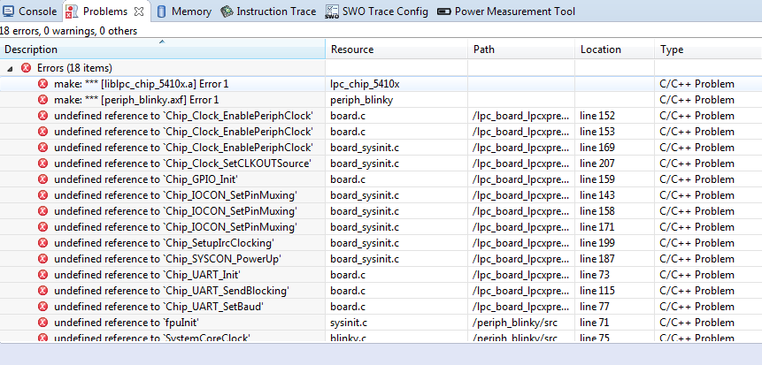

   I am using LPC54102 development board
   I have installed LPCXpresso_8.1.0_597 on my PC (Windows 7 with 64 bit OS) and imported example project. When i clean and build the project it creates the issue like below
Imported projects list
    1.lpc_board_lpcxpresso_54102
    2.lpc_chip_5410x
    3.periph_blinky
I have previously done all those things but currently i have formatted my PC and re-installed LPCXpresso, then it is giving this error.
Can you give me your suggestion to solve this problem

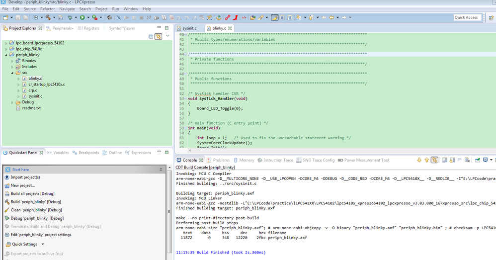

   You don't tell me what the code you are using? LPCopen? or SDK2.2?
   If you are using the LPCopen, tell me the version.
   It seems you are using the lpcopen code.
  I have tried lpc5410x_xpresso54102_lpcxpresso_v3.03.000_16 which is downloaded from this link:
 http://www.nxp.com/downloads/en/software/lpc5410x_xpresso54102_lpcxpresso_v3.03.000_16.zip
  After build the lpc board and lpc chip library, then build the blinky, no error on my side.

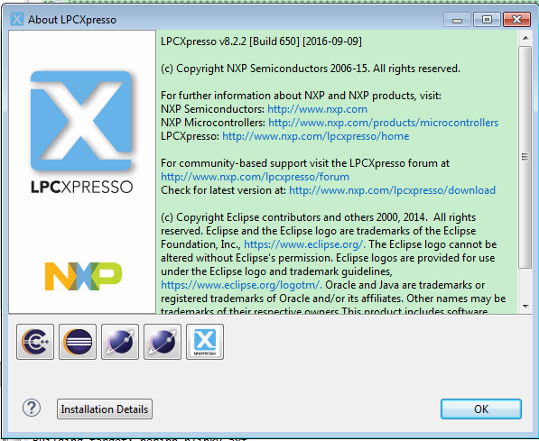

  Besides, my lpcxpresso IDE version is:
You need to download the latest lpcxpresso IDE:
LPCXpresso IDE v8.2.2|NXP

   When you build the project, you must build the two libraries at first.
   Besides, actually, you also can use our sdk sample code for lpc5410x, which can be downloaded from this link:
Welcome to MCUXpresso | MCUXpresso Config Tools
  SDK builder, then choose the board as LPCXpresso lpc54102, then generate the according IDE project, and download it.
Kerry
