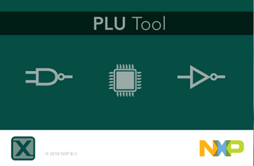

Programmable Logic Unit (PLU) offers an interesting functionality in the MCU world. It allows the possibility of creating small combinatorial and/or sequential logic networks including state machines.
In this short blog post I present one of the possible errors that you may encounter while integrating the PLU code (generated from the PLU configuration tool figure below) in your overall application code in the MCUXpresso IDE.
The board that I am working on is: LPCxpresso55s69.
Let's take the example of AND function that you would like to implement using the PLU module.
An option is to use the PLU configuration tool.
The generated code from the configuration tool would look like:
