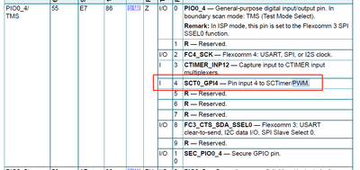

Pin 53 and 58 can be used as PWM output pin but Pin55 can be only set as input. see below extacted from DS. If we need PWM output, we need to choose another pin which can support PWM output.
Hope this will help you,
Jun Zhang

Now our PCBA has been completed. Can we control 55PIN by using 53PIN (ctimer0_match1) and simulate output PWM waveform through GPIO output?Is there any other way to do PWM control without changing the hardware?
Thanks!
2,219件の閲覧回数
ZhangJennie
Hello JJ3 ,
Yes. you can use  53PIN (ctimer0_match1) to output to a spare GPIO. then set 55PIN as GPIO to synchronize 53PIN output.
Hope this can help you,
Jun Zhang
