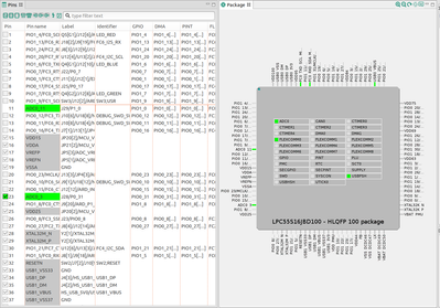

I configured the pins using config tool
Screenshot from 2021-07-13 15-45-46.pngScreenshot from 2021-07-13 15-45-46.png

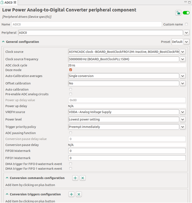

I configured the clock
Screenshot from 2021-07-13 16-03-12.pngScreenshot from 2021-07-13 16-03-12.png
Peripheral:
Screenshot from 2021-07-13 17-52-22.pngScreenshot from 2021-07-13 17-52-22.png

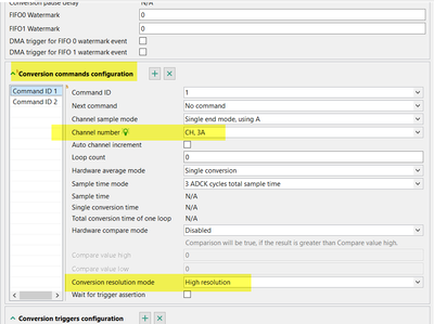

Hello ,
About ADC channel and 16 bit resolution, you can config in "Conversion commands configuration" :
If can't get data, recommend first use ADC demo under SDK to test, and select and connect the right pin.
